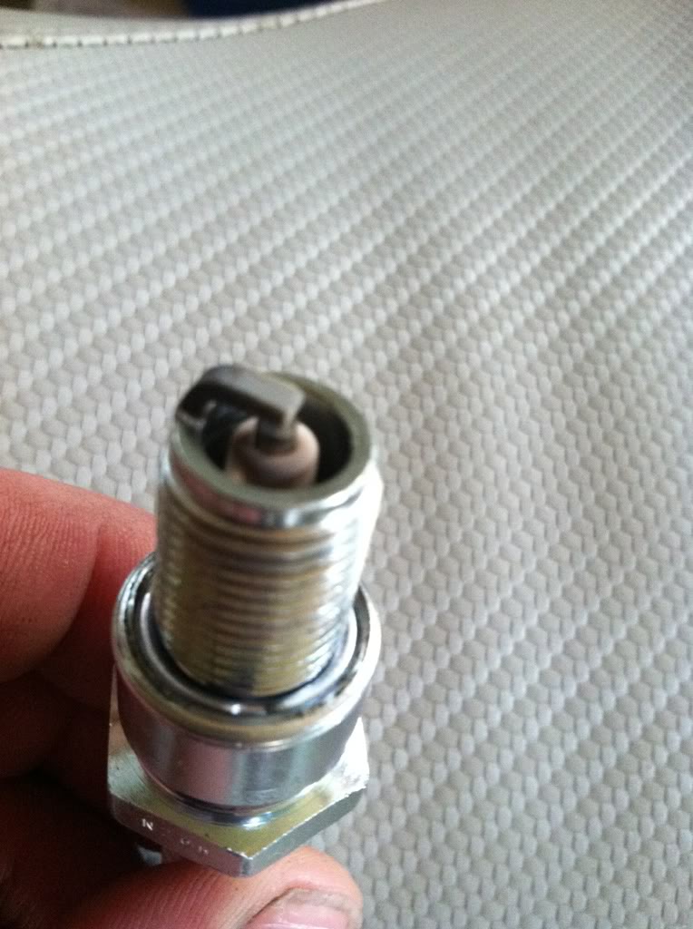

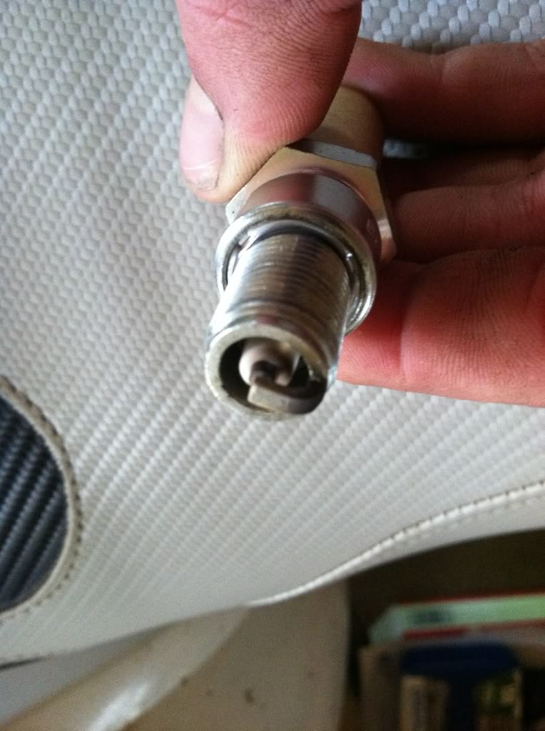

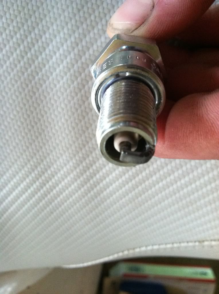

Im not real certain that the 148 is right either. I tried 140, 145, 150 with plug checks. I performed the plug checks by starting it then immediately WOT up through 6th gear then pulled the clutch and killed the engine. I have a pic of each plug for each pull. I really cant see a diference between them. Plus the brown is only on one side of the plug nothing like the ring Ive seen with other members pics.
140 main:
145 main:
150 main:
I couldn't figure out how to cut the threads off. Tried using a cordless drill and hack saw but it just wanted to slide away using the path of the threads. I can see down in there and it looks all white except for one side at the tip.

you have to hold the plug in a vice and cut with the hacksaw, rotate as needed
