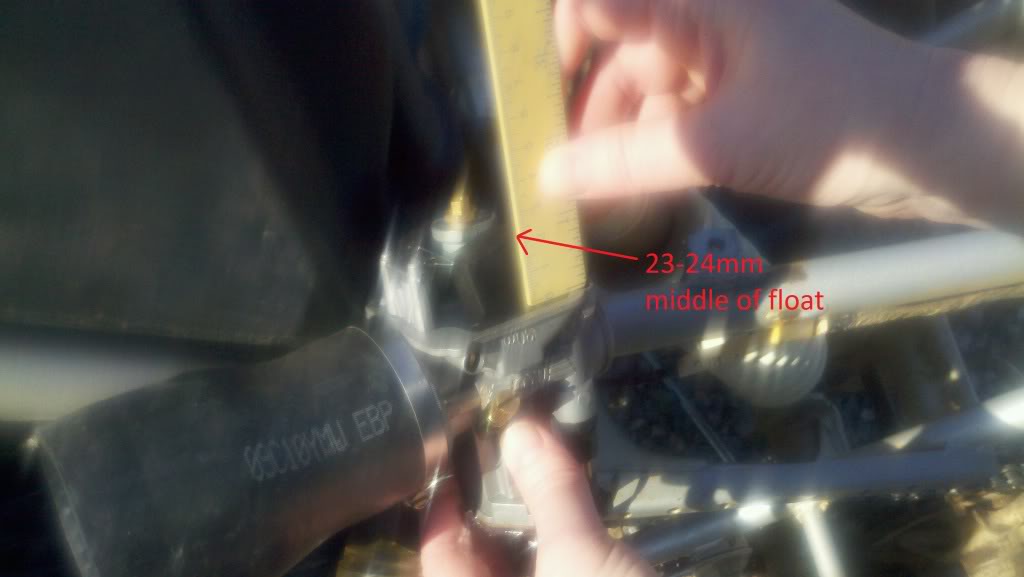

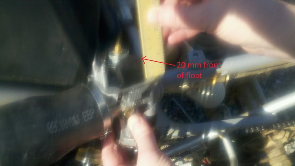

does this look right for the float level?
Its 20mm in the front, and about 23-24 in the middle where the floats highest point is.
Float level should be 19MM. Here is how to check it correctly.-

Before changing any jetting parts, check the carburetor floats for correct height. Measure the height from the bottom of the float to the Throttle Opening. carburetor-body gasket surface. Correct height can be found on the chart. When checking the float height, the float should be resting, but not depressing, the spring-loaded float valve pin. This can be done by tilting the carburetor until the float tab just makes contact with the valve pin. If adjustment is needed, bend the metal tab on the float arm until correct height is obtained.
