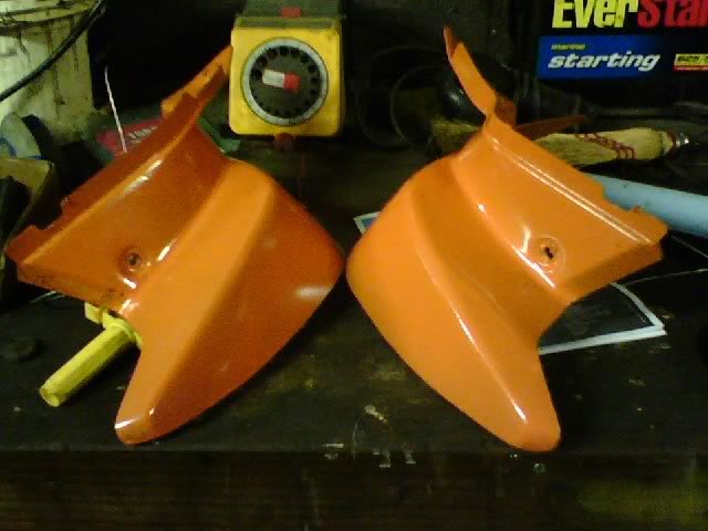

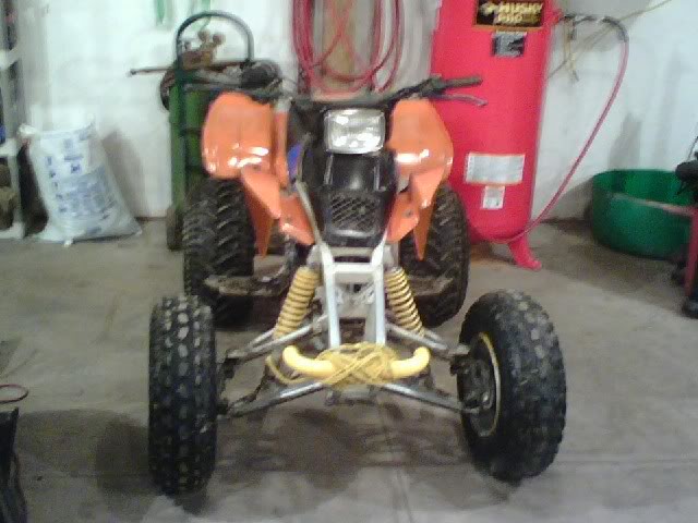

krylon plastic pain, i painted mine this weekend but they didnt have my color, so i bought krylon plastic black , then painted over it in the orange i wanted, my quad is now black and orange except the ugly blue seat
heres some pics
they had some spots where the paint didnt stick cause of oil, so be sure to not touch the fenders with your fingers after you wash them off, and make sure you hang them so the paint doesnt run all to one spot, the first coat will want to run and look like sh*t, do alot of light coats, i used 3 cans onf orange paint on my front and rear fenders
