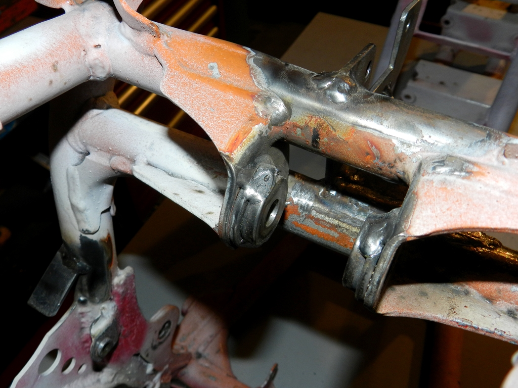

Get the 400EX bush kit from KOR. NOT the one on ebay as it is aluminum and cannot be tack welded to the frame to keep them in place.

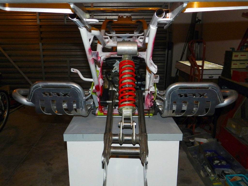

This is before I cleaned is and changed colour of spring.
After Clean and powder coat.

400EX shock is easy to fit and and only modification you need to do is drill the lower shock mount on the shock to 12mm. Install the shock using the bushes kit that includes the longer bolt from KOR and use the stock pin in the lower shock k mount on the swing arm. 30min job at most.
I welded mine in but you don't have to as they are a press fit.
