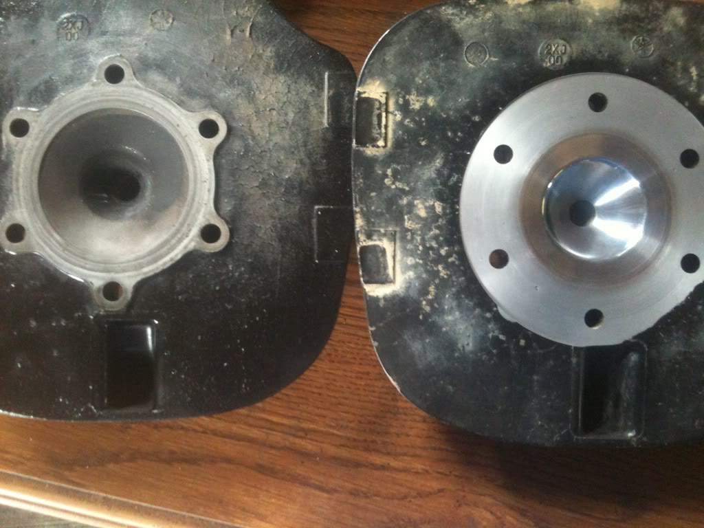

Torodial cut into the head favours low/mids, hemispherical cut into head favours mid/highs.
Two methods of rechambering.
What exactly does that mean? How's it different then a rechambered head?
It changes the way the air/fuel explodes in the cylinder increasing the down force on the piston. That's the simple version. Here's a pic of the difference. Stock head on the left.
