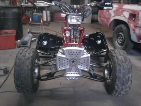

Just bolted up my knuckles and the quad seems lower is it to low and if so how can I adjust the shocks to give it more height
adjusting shocks does not raise/lower it, only different length shock will.
whats the measurement from ground to bottom of the frame ?
what length shocks and what a-arms ?
the backend looks low too ?
Idk All I kno is that the a arms are +3 up 1's and the shocks arnt long travel but with my old arms the front didn't sit that low...... Help???

usually + swingers add height, but that looks stock or lower in the rear, what shock, what swinger ? if homemade ? was the mount moved ?

Looks to me that the back is pretty low compared to normal. My guess is that the swinger you have has the shock mount farther back than the size show you have in the back. As for the front, your swing arms may have the same problem, the mounts on front look too low for the shocks you have mounted at the moment.

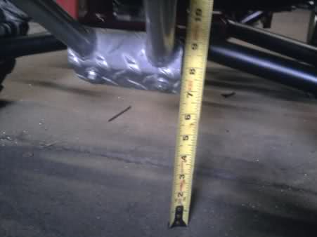

here's pics of mine with stock length shocks on LT arms for 16-3/4" shocks ....
i had 7" ground clearence...unacceptable !
i welded on higher mounts and now have 9-1/2" front and rear.
9-1/2".............
