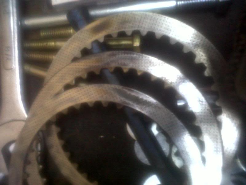

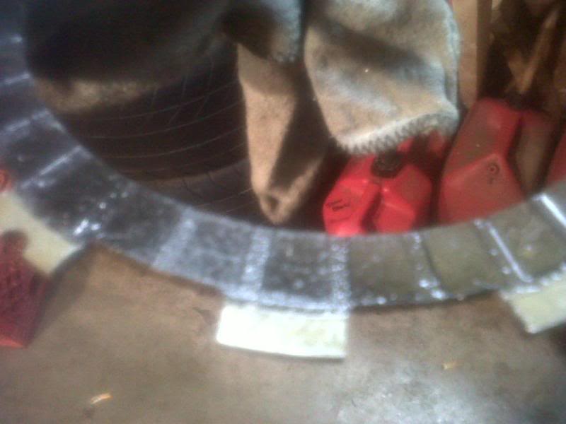

puled the clutch out of the lt tonight... ordered all the new parts already
what ya think????
from my amature opinion it doesnt look bad at all, when we did my engine rebuild pulled the clutch just to check it and it was still good as can be from 2001
but your clutch doesnt look bad, but im no pro

it slipped under load.. i could snap it and launch, but 3-4-5-6th would slip
hmmm id, but the plates dont look bad,some times you can fix the clutch slipping just by adjusting it, thats what my dad did on his 250r before he rebuilt the whole engine, clutch and all
your steels have burn marks. i am thinking the clutch wasn't adjusted correctly.
i adjusted it when i owned it in spring and it was better for all of 20 min, and its been rode all summer but the prev owner with the clutch bad... the fiber disks are almost smooth, pressure plate and clutch basket look mint though,
and i see what you ment by adjusting it sucks .. there bright idea for the notched rod going threw the clutch into the arm for the cable is a brilliant idea 8-|
dimpled steel plates will slip at load in the jhigher gears put undimpled steels in and teh problem will be gone of course id also stick new fibers in at the same time
