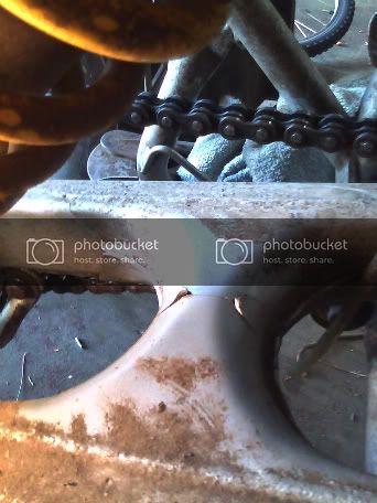

My swing arm is cracked on the top and im not sure what i should do. I dont even know if i can fix it or if im going to have to get a whole new one. Any suggestions?
you can weld it however it will probably not last long i wished you lived closer to ny i have 2 swingarms just sitting around i would give away but yeah your better off buying one they really cant be much
Im not even sure where i could find another swing are for cheap. I think new they are like 200 or something. Im not really sure though.
Best bet is buy a +4 swinger from the swing arm shop , and of course you'll need a longer chain and brake line/cable . I wouldn't trust the stocker anymore , its telling you to do something about it.
I would say get it welded. I have cracked two in that same exact spot. and cracked the same exact way. weld that mofo or you will just crack the next one the same way.
