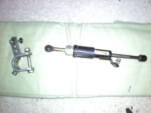

i won this bad boy on ebay lol. so how do i mount this thing up? And i thought it would be bigger too but i guess not lol.
the horseshoe thingy goes around the steering stem a few inches from the bottom, and i believe those peps are made to bolt at the back where the fender brace bolts on, remove the stock bolt and put that one down thru the brace, make sure to leave all bolts loose for adjusting, till you get it correct, then tighten, and this will all need done with the wheels perfectly straight

well i tried but i cant seem to get it to work lol. if any body has got pics of theirs mounted that would be great! thanks guys.
looks like you might be missing the frame mount by the looks of 305 pic
good call yb.. he is missing the clamp i got mine the same exact way of the bay used..
blanshee what i did is take a 3/4" pipe clamp and wrap it around..bend the tabs straight out. stick the bolt through and a washer and nut and bam homemade frame clamp or order the one for like 15 bucks..
it might have been a 1/2" pipe clamp. works great tho..

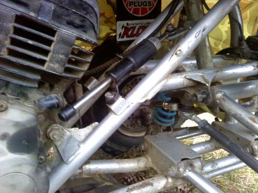

i told you above that it mounts like that, glad ya got it, give us a report on it, i like mine, can tell a difference, but it gets way too stiff for my riding if i set it above the 3rd setting
lol i know thats how you told me but i just couldn't get it for the longest time then it just seemed to work lol read my pm you'll know why i couldn't do it lol and ill deff get a report as soon as get it all back together. thanks again!
The peps mount differently than than the denton,streamlines etc.I like my denton stabilizer a ton.It's a great mod.I still have the same pep one sitting on my bench taking up space.lol Seems way to loose compared to my denton.If you need parts for your stabilizer blanshee lmk I'll send it to you on the house.lol
lol thats the same with mine.......i cant turn the damn bike when its set after the 3rd setting.....but wow what a diffrence it makes for sure
