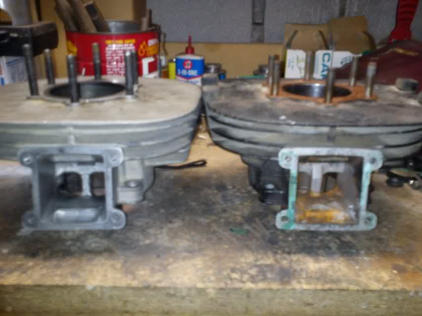

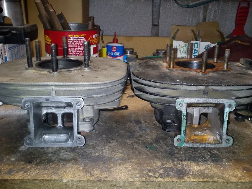

VVVVVV ported vitos 240 Big Bore cylinder vs Stock Cylinder
cylinder comparison stock rusty one vs vitos ported big bore

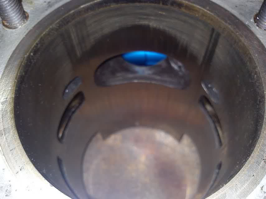

Vitos 240 sleeve notice the triple exhaust ports

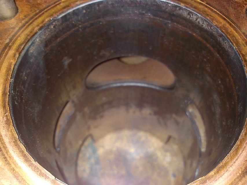

stock cylinder sleeve noticed how it dosent have tripe ports

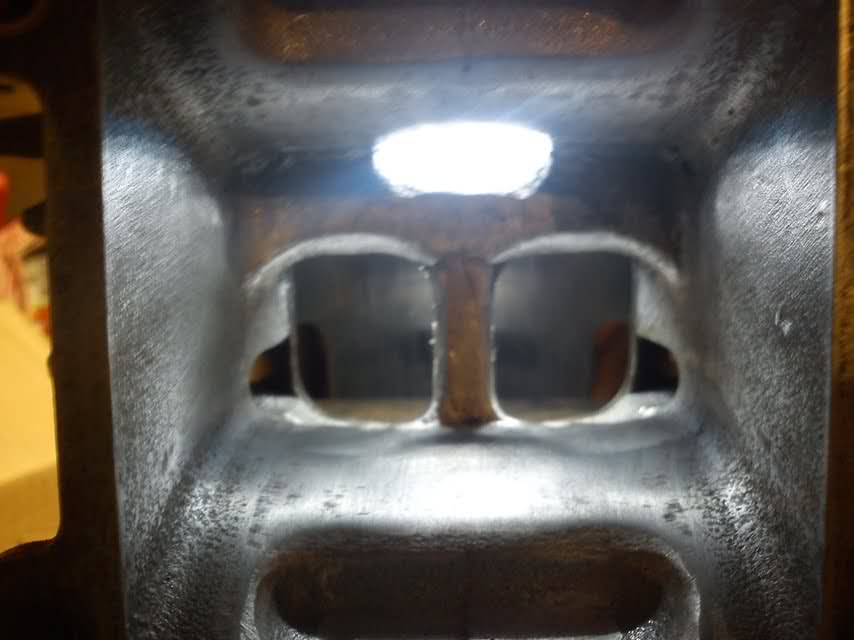

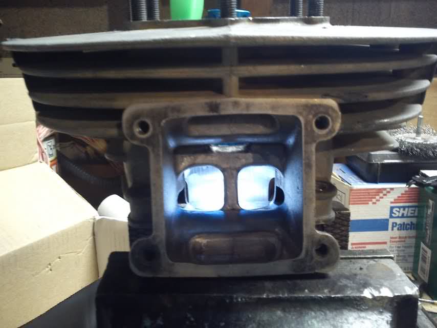

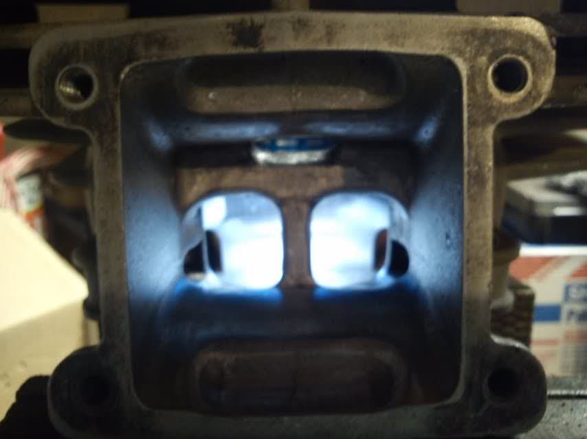

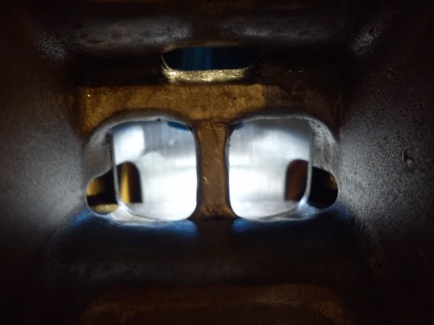

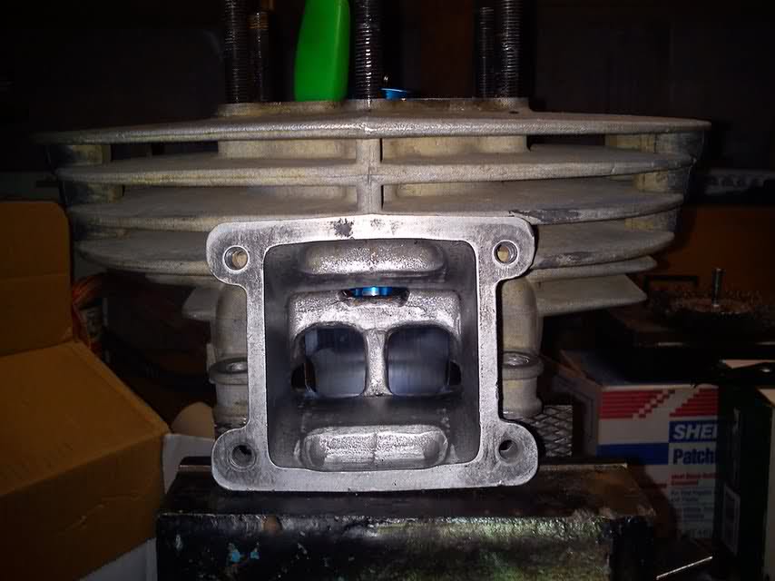

my ported 240 big bore cylinder

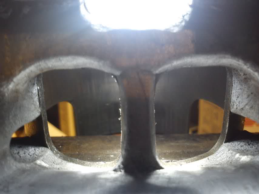

a enhanced view of my vitos 240 ported intake
Another pic of my vitos 240 ported intake
The vitos 240 is coming to life and guess whats It's Alive
^^^^^^^who can see the smiley face in theese picsvvvvvvvvvvvvvv
Vitos 240 Big Bore ported intake
