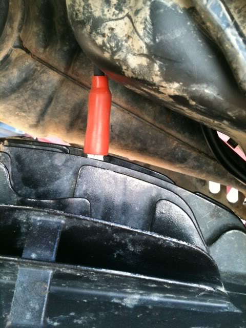

Ok so i have gone through three boots in the 2 months Ive owed a Blaster so i decided it was time for something different. I had an extra plug wire laying around the garage so i pulled the boot and uncrimped the connector. i recrimped the connector on the blaster coil wire (be careful uncripming and crimping so you dont break it). i added a little solder and slid the boot over. Ive been riding for a few weeks now without a single problem. I:I I:I
