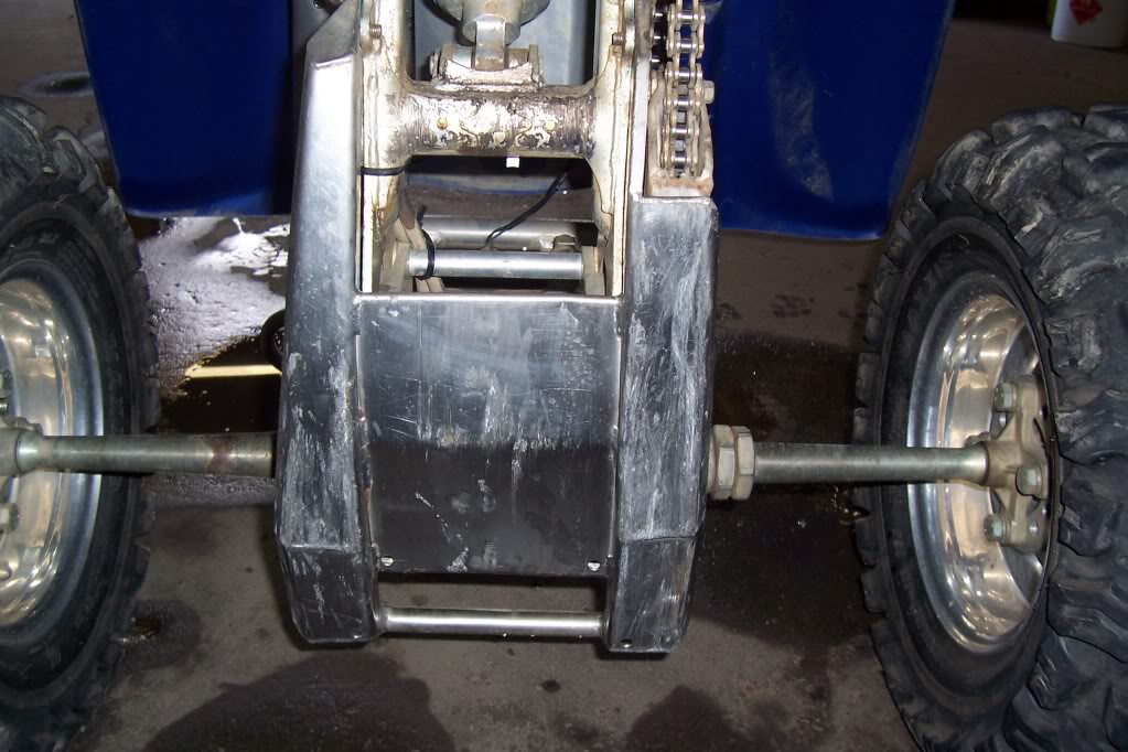

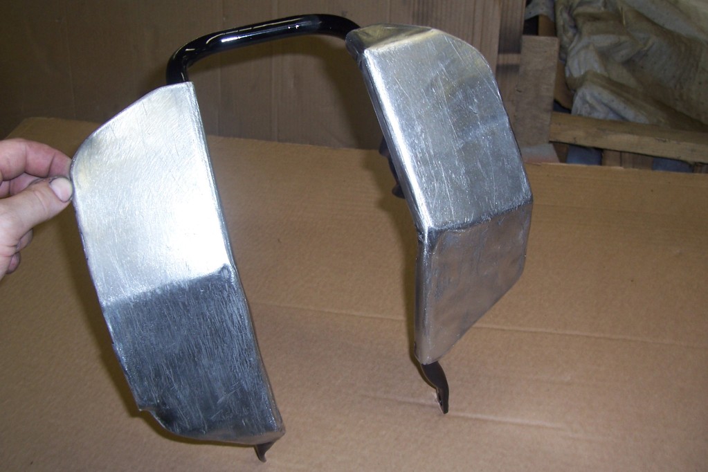

After awks mountain VVVVVV
Before awks mountain VVVVV
This is the 1/8 stainless skidplate that i made for the 4 1/2 swingarm extension that i had.. The pic was taken after Awks Wild Ride 2..
