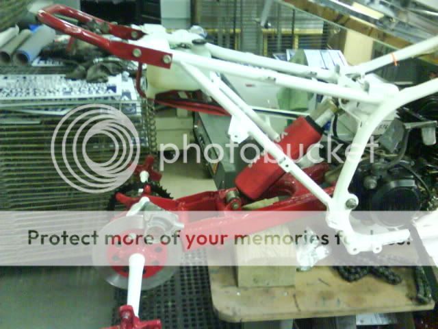

On mine I got box the same size as the swingarm, I think 1x2 and cut two pieces 4" I then got some 1/2 flat and cut 4 pieces 8" long I plug welded the flats inside the swing arm for support and guide. I cut my swing arm right after the shock mount, so I had three pieces. I seen someone on here cut thiers before the shock mount and extended it there using the new cross tube for the new shock mount. Which was probable easier because I had to relocate my chain guide and skidplate mounts and he didn't.
In the second pic you can see the flat standing on end weld across the top for support. All in all I probable have 4 hours including sandblasting, paint and rebushing it. It is amazing how much it improve the ride, alot more stable and the front end stays down.
Don't forget your going to need a new brake cable and chain or atleast 8 more inches of chain.
