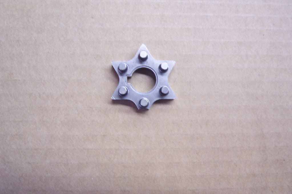

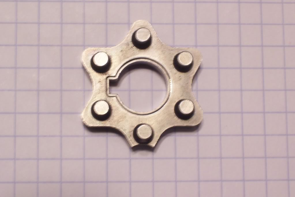

I was wondering how far to bring them down. I may bring them down a bit more... Thanks!!!
So then the pointy one with a inverted radius at the bottom must be neutral? used to get hung in between gears, i see six points, six valleys, six gears, but wait theres seven "gears" with neutral 1N23456
"1234567"
Wonder if you knock one of the sides off of the one at the bottom if it would make neutral easier.
Maybe instead of rounding them off like there worn out if you "shark finned" them in eather direction, made it look like a skill saw blade?,,, maybe it would help shift and keep it from getting a false neutral between fifth and sixth:-[

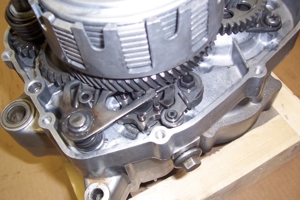

how far apart do you have to take it to change the shift star?
I was wondering if that would be a problem if you grind a lot off of the point....
what difference does it make modding da shift star is in make the gears closer or to stop it going into nutroll when u go from 1st to 2nd
grind em down man!!!!!!!!!
lookin good.
i take a good bit more off them than the one you pictured and have never had a problem. i believe if it was this bad there had to be another problem unless it was cut down almost smooth.
Thanks bro, i will be taking the star back to the belt sander....lolI:I

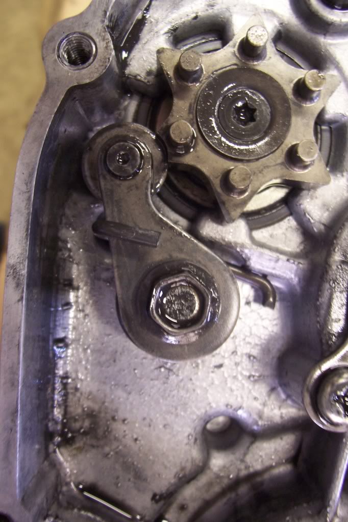

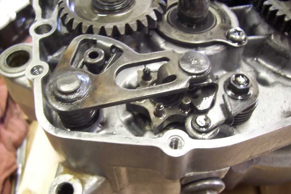

See the star and theres a wheel against it and that wheels on a lever under the flange head bolt,and the lever has a spring wrapped around it,,,
Ive also heard you can cut a notch into the lever where the spring rides on it to ease off some of the spring tension for easy shifting.
