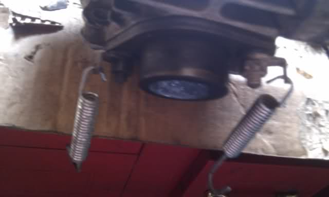

I tried one once and it seems like it came with little tabs that slide over the stud and then the nuts. The tabs have a hole for the springs to hook too.
You can make some easy. Take a stip of flat metal 1" x 1/2" and drill a hole big enough to fit over the stud at one end(close to the edge or it will hit the pipe) and on the other end a small hole for the spring. You put the flange on and then the tabs and then the nuts.
heres a pic of the tabs so u have an idea, they go on the studs for the manifold
