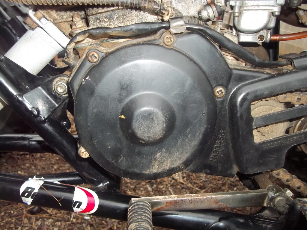

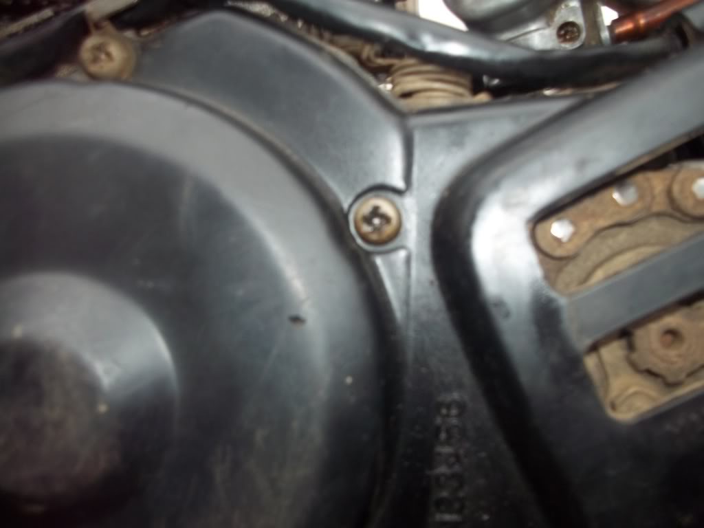

Hey im trying to get my stator cover off to switch to a 14t sprocket but the screws are stripped does anyone have any ideas to how i can get it off?
If you have a dremal with cutoff put a slot in it. Or small cold chisel, start by making a notch on face towards edge then tap in direction to remove. Smacking on face to put notch also help loosen, kinda like a impact.
Yea i have a dremel but what do you mean a cutoff?
what i do before i strip them all the way out. (make sure you use a #3 not #2 phillips) hit the back of the screwdriver with a hammer then put a cresent wrench on the handle of the screwdriver to help you turn it. push in on the screwdriver while turning the cresent wrench with the other hand
An impact screwdriver will take that off with ease. Anyone who works on quads should have one in there tool box, it has saved me many times. I have also used vise grips from the side angle to free them in a pinch.
