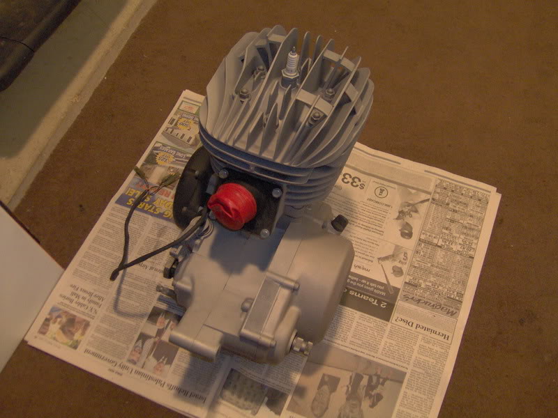

hey paulie what did you use to blast the motor a friend told me you shouldnt use sand he told me i needed a soda blaster because sand would pit the aluminum an would i need to take the motor apart or would the seals an all that be ok
I use '000' grade- very fine sand.
Your friend means well but is over cautious.
I could see soda bein a lil easier then sand on metal.
Were not painting coucorse winning show cars here.
I'm not by any means try'in to say I'm the best at painting or PC'in,
but the finish I layed down on both is pretty good lol.
Unless your bud is a seasoned pro with a soda blaster and HVLP paint gun,
I'll put my sandblasted, rattle can work up to his anytime.
The most important thing is to take your time.
Last but not least go price a soda blast unit and the media needed.
Kinda defeats the purpose a lil bit.

thats what i wanted to hear thanks, my friend is a lil overly cautious but he has some knowledge too now that i know i can do this the easy way i might have to take the blasty apart again an sand blast it my concern is will i have to take the motor apart or can i do it while its together the topend isnt a problem i just dont want to try an split the cases
i bought some black beauty medium grit the other day from a local bagging supply. any body use this before? it seems to work amazing especially comparred to HF's 5lbs of aluminum oxide for like19.99. i paid 11.23 for a 80lb bag.
I have used black beauty before....a little messy...but works well at cutting off the old material
Yes....please do not try it assembled. You use sandblast media with 90lbs. air coming from a gun then its gonna rip gasket material off with it. You are gonna get sand in that motor. That would look nice, but run pretty poorly

I blasted my motor fully built.
I used a rubber plug for the exhaust and 3 balloons on my intake.
Check your ignition wire loom coming from your magneto cover.
If it looks like sand will get in put rtv sealant around it.
The sand will bounce off anything rubber.

what did you do for the kick starter shaft an shift shaft to keep sand from getting in there
I did nothing but not try and blast directly at the seal.
The factory paint on the 3 different motors I did was pretty weak and came off easy.
