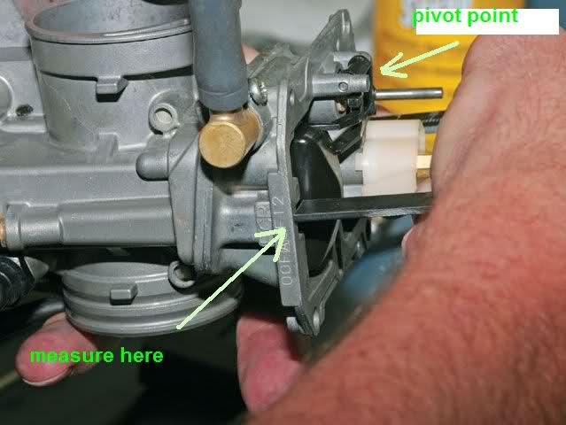

i've had a hard hit knock the float level out of specs.
while your cleaning the carb.........
http://www.blasterforum.com/general-support-17/how-clean-your-carb-pics-209/
aslo check your float level, on the stock blasty carb it should be 20-21.5mm,
measued like this,
bend center tab slightly up/down to adjust...........
