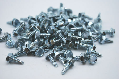

89blaster89 Member Aug 26, 2011 4,739 26 90 30 Pacific northwest, washington Jan 19, 2013 #1 i just got a used ct silencer and its missing a few rivets, what type of rivets should i use when i buy new ones and were could i get them? sorry ive never had experience using rivets

jays blaster New Member Jul 5, 2012 196 3 0 Jan 19, 2013 #2 Jegs performance and sumitt racing has them they aren't that expensive , harbor freight also
Awk08 Administrator Staff member Technician Jan 30, 2009 24,427 2,295 175 Usa Jan 19, 2013 #3 i don't re-rivet, i use 5/16" hex head self tapping screws............ with a little dab of hi temp ultra copper on the threads to keep them place

89blaster89 Member Aug 26, 2011 4,739 26 90 30 Pacific northwest, washington Jan 19, 2013 #4 well im goin to home depot later so ill see what they have there i guess
