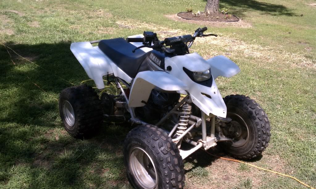

Rice's Blaster rebuild
Pics for the win
BTW: One of the Powersports parts suppliers I went to for jets said "I'd be highly surprised if you got that thing running at all with that LARGE of a carb on it, I'm not trying to discourage you but ive seen it attempted many times".... Lol at that fat prick

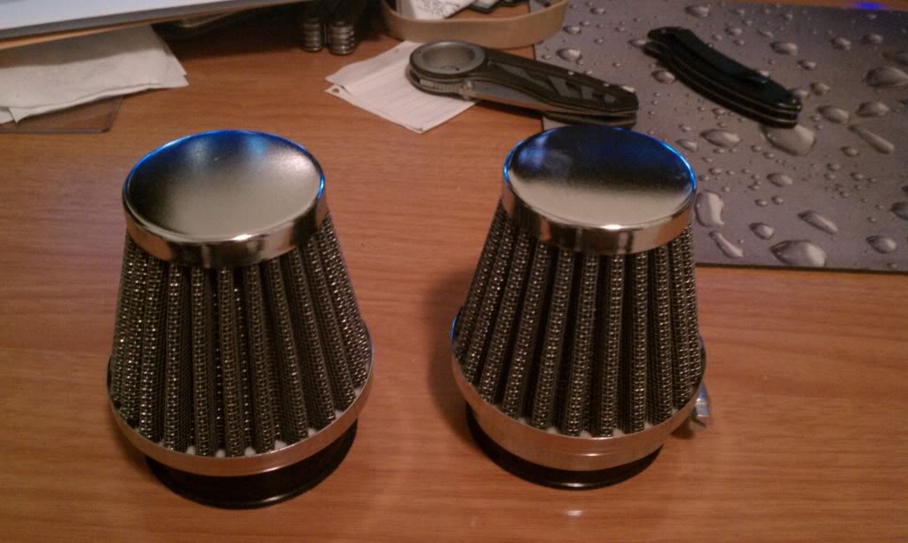

my 34mm pj...............
45 pilot, "dgh" needle, middle clip, 155 main/162 cold weather jet
the needle change is where it's at !!!!!! i've seen "cel" used too
check yours
i also use the cable for idle adjust, i hate that choke knob BS.
ps. .........package prolly headed your way by weeks end
The needle in the carb now is a R1469N. It comes up as the stock 86 TRX250R needle. I do not know where to find the three letter code for the needle length, girth, taper.
