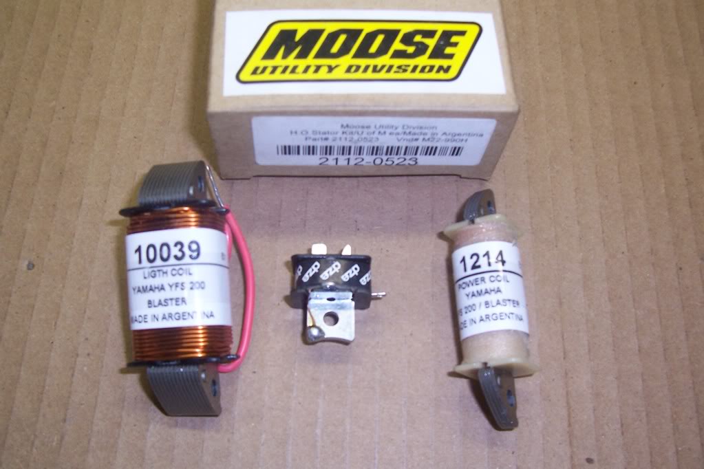

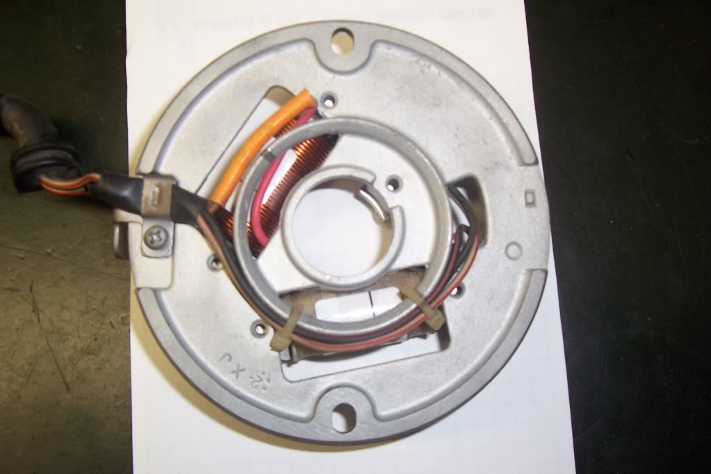

Moose High Output Stator kit VVVVVVVVVVVVVVVVVVVV

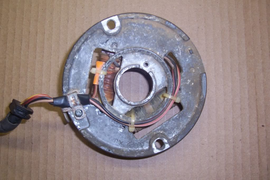

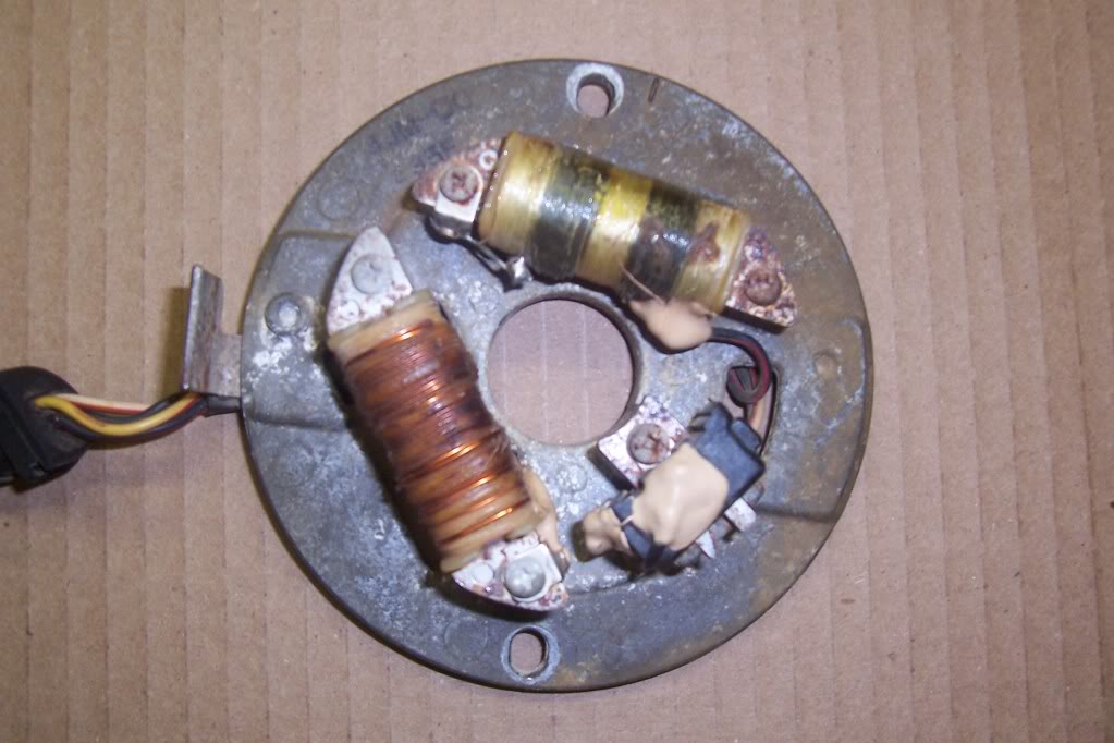

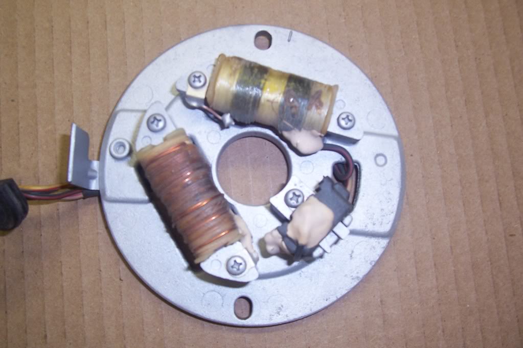

The old stator VVVVVVVVVVVVV
The old stator after getting blasted VVVVVVVVVVV

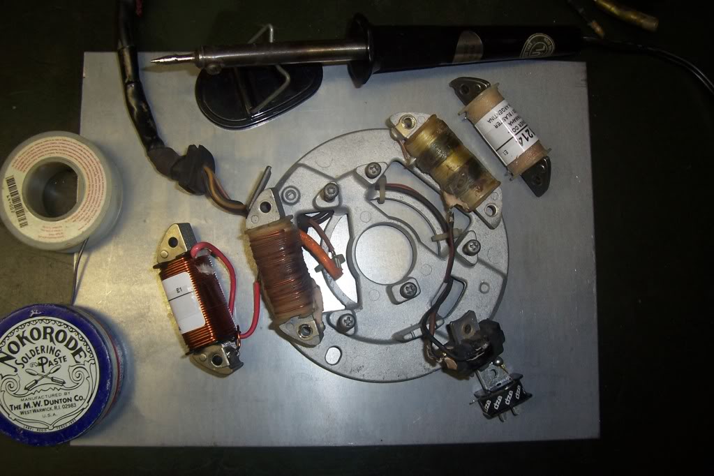

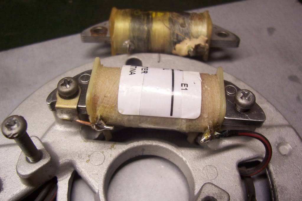

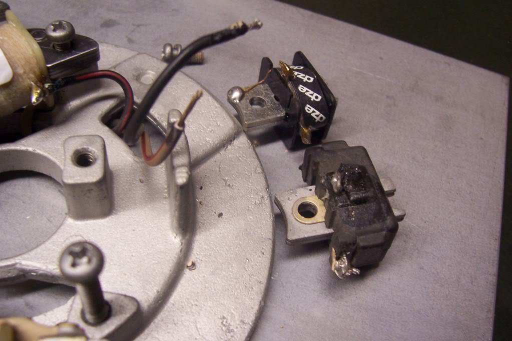

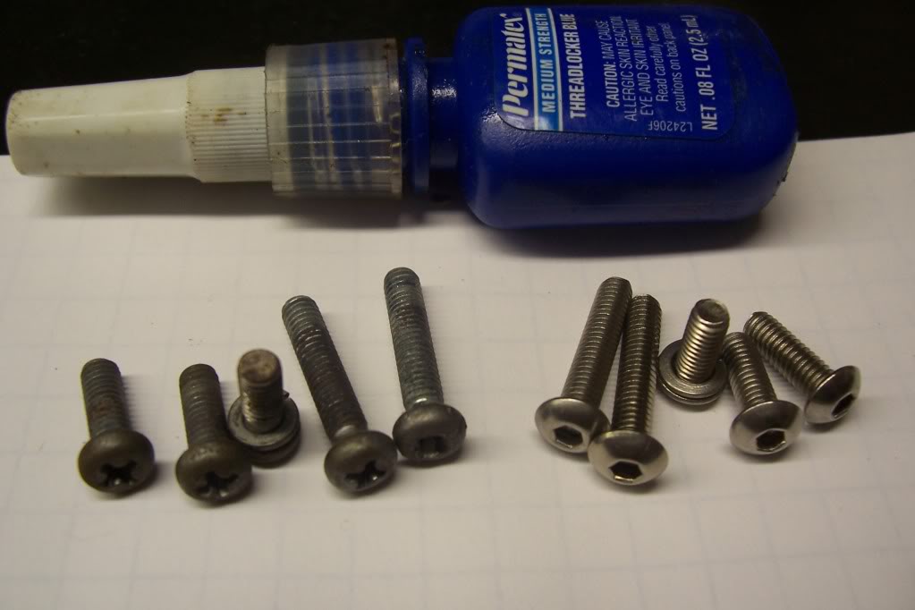

Everything is unscrewed and ready to get removed with the soldering iron...

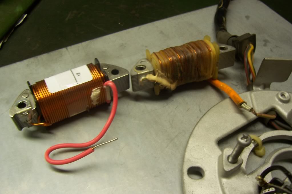

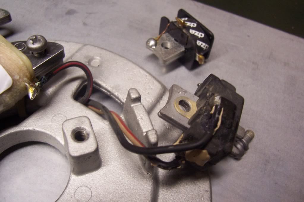

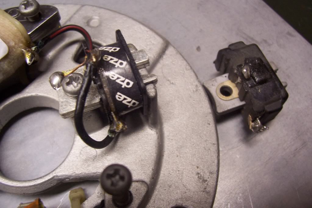

The old pickup coil VVVV
The old pickup coil removed VVVVVV

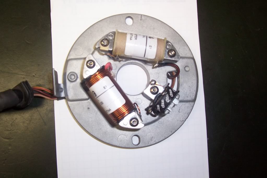

The new pickup coil soldered and in place VVVVVV

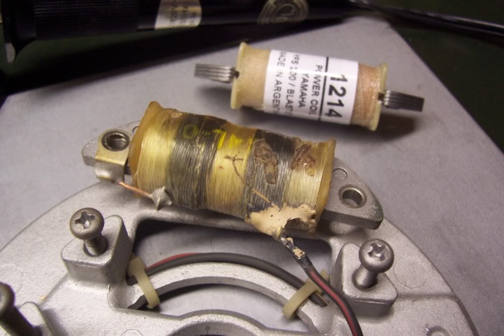

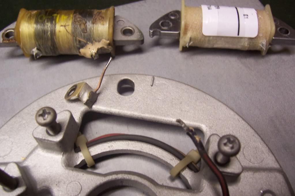

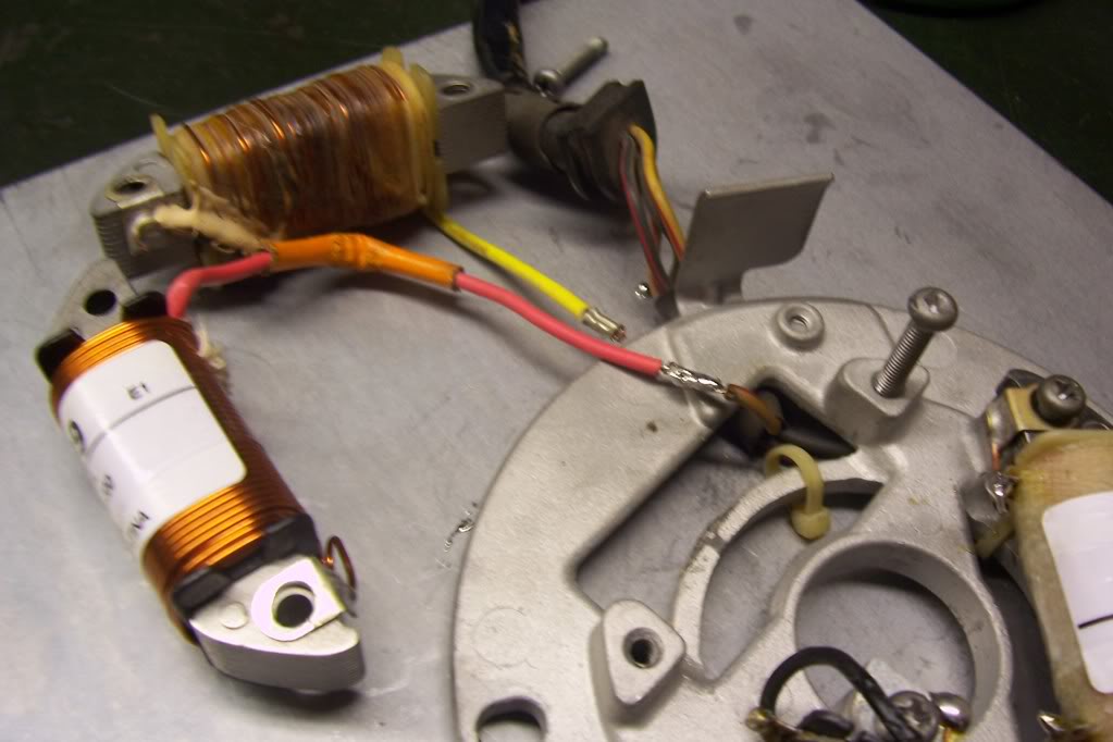

The old power coil VVVVVVV
The old power coil removed VVVVVV

It WORKS!!!!! I put it in this past friday and it started up on the 1st kick, and the lights worked to...lol The two 35w lights stayed brighter and steadier at lower RPM with this 75w light coil, then they did with the Ricky Stator 75w light coil... But i dont know if the Ricky Stator 75w light coil was working right because it BROKE after about 1/2 of a day of riding....

Nice Bronco, great write up! I just done this myself. Not a moose kit but ricks motorsports up in mass- but my coils say the same thing and spelled wrong too made same place!
Havent tried it yet, I also used liquid electrical tape to cover the soldered connection on the source coil.
I also removed the paper labeling(sticker).
I also removed the labeling stickers before i put it in the blaster, and I thought about using some liquid electrical tape but decided not to in case i had a problem and had to unsolder and replace anything.... I don't know how hard it is to remove liquid electrical tape but the stuff that is covering the stock soldered connection is a bi%ch to remove...lol
Will not cover the soldered connection on the source coil give me a problem????
I Don't know if it will cause a problem brutha, I just figured the stock was covered so....
And to remove the liquid tape small wire brush worked for me!
The only problem you might have by not coving the connection is corrosion if you get water inside your stator cover. Otherwise, the power output isn't high enough to arc the gap or anything and there shouldn't be anything in there flying around to cause any trouble...
