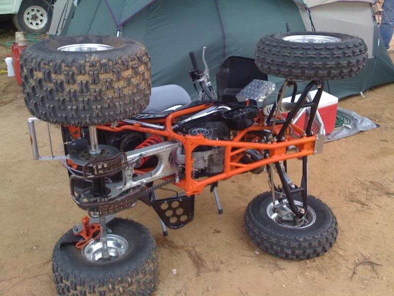

Hells if you don't even want to change the oil just lean you blaster over on it's side.
