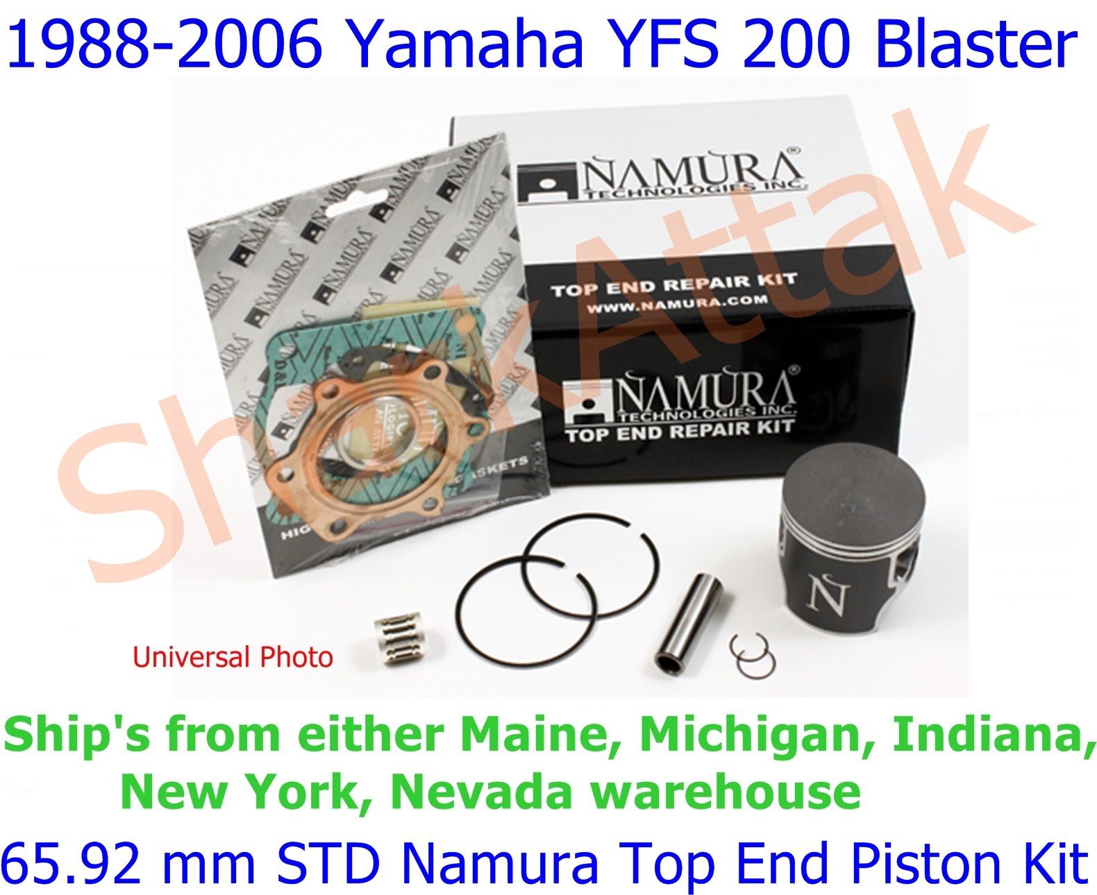

So I bought a 2000 blaster, for 500 "guy" told me it needed a carburetor clean which I did and it started right up. He said it had oil (BIG LIE) got all excited fired up and took off ten minutes after doing so it shut off. No compression took it home took the head and jug off (BIG PROBLEM) the piston skirt has broken off but the motor is bone dry . Which is the reason it broke right? so I've gotten all the pieces out ran some diesel through it and ordered a standard 65.92 nameradu piston my question is if I just hone it and don't bore it what will happen will it ride? Theres a few tiny scratches on the jug but that's it.
