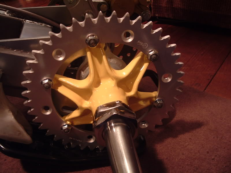

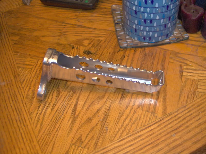

Might as well add a couple that I did.
I used an Eastwood hot coat gun- entry level.
Here's Eastwood single stage chrome:
Eastwood hi-gloss black:
Eastwood mirror yellow:
Did you put the clear over the chrome, or use the single stage? I never had good luck with chrome...it grayed out on me. Using it as a base for transparents was always good for me tho
I did not clear it and it was a big mistake.
All those pieces grayed out on me too.
I'm not giving up though, next time a use it I'll clear it.
Yeh the chrome actually comes to the surface when you bake it. When it cools, scratch it with a fingernail and watch the scratch turn black.
They make one stage chrome from eastwood and columbia. It may look better than putting clear over it.

That was the single stage chrome from Eastwood
