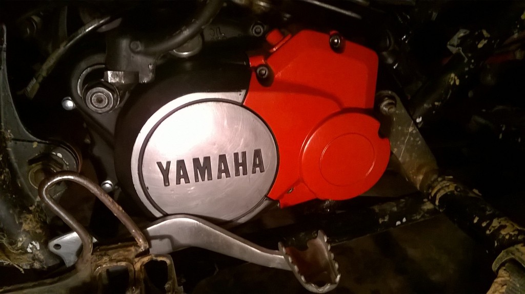

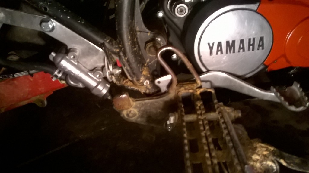

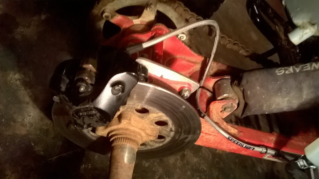

Looks great! It's nice being able to stop.Got the cylinder installed and everything back together and leak tested (Pass) I haven't fires it up yet I will wait till tomorrow to do that. I am going to do heat cycles tomorrow as well. I also cleaned up the clutch cover and added a little character to it. Thanks to @Fas6hand for the brake setup, got the back on now just waiting on the rest of the parts for the front.![]()
