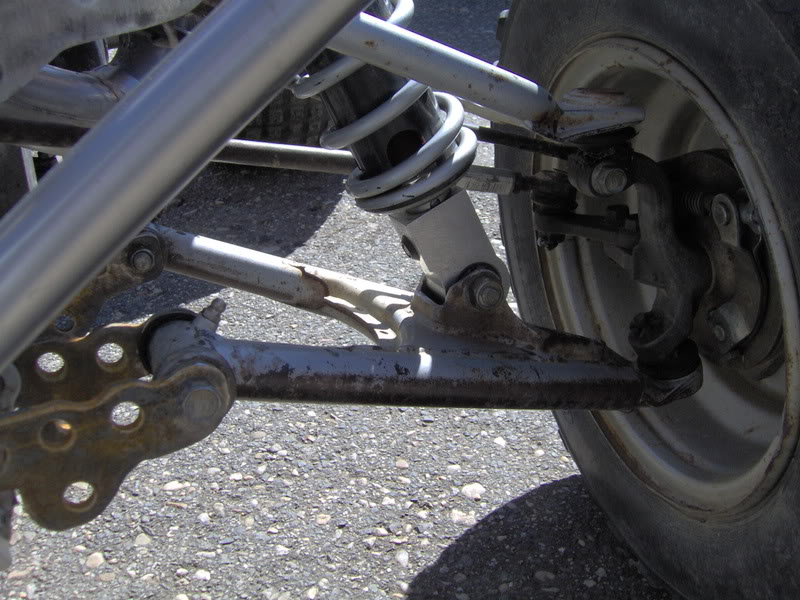

pic of bottom mount grinding

Here's a pic of the cutting I did for the rear. It's a no brainer and a hacksaw or jig saw will take care of it fast. After you cut it drill your holes for your lower mount bolt to go through. Make sure you select a drill bit that is EXACTLY the same size as your shock bolt.
