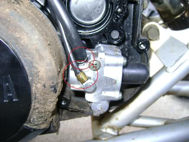

i took a picture of what i think is the oil pump. not 100% sure tho. but if it is. if i remove the 2 lines goin to it, one is electrical and one is oil i think, will i be able to take off the oil tank and start mixing gas or is there a kit i gotta buy?
the big one is the line in from your oil tank. the smaller one is the line out to your carb. If you pull them out and block the line into your carb you will be fine. The block off kit just makes it all nice and neat. i just have ny gutted pump sitting there.
Remove the gear and plug the two lines comming from the pump. Then get the smallest size carb vaccum caps you can find at auto zone, fill the cap with silocone, now use this to plug the brass nipple on the carb.

Its pretty easy just take your time.
Did you buy the quad? If so your parents don't really have a say. And also the gear is plastic!! It stripps and cracks, comepleatly unreliable. Too may blasters have seized because of pump failure, save yourself for the same headace.

it i sometimes a pain in the ass to premix, but its reassurance. i would much rather premix. cant afford to rebeuild when the fix is something that easy. now...does anyone know where to get a cool plate to replace the cover?
finally, somebody got to you b4 i did. this has to be teh 5th time i said soemthing about this....you dont neede those kits, as you have found out. gear is plastic and fails all teh time, as you have found..blah blah blah....im just restating whats already said....good job getting rid of that big mistake pile of crap oil system......everybody should do this...IT SUCKS!
