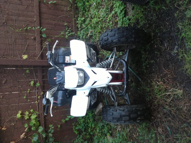

Hi everyone I'm new to the forum and new to blasters and 2 strokes actually. Just wanted to say whats up and show y'all a picture on my blaster it's a 04 and stock well never mind I can't do it from my ipad!!

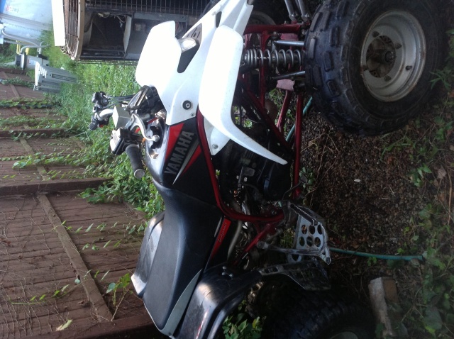

Thanks!! I have a lot of work to do! so far I greased the front calipers ,put grease in all the fittings, repacked 1 front wheel bearing with grease ,and changed the other front wheel bearings also disconnected the t.o.r.s! Still doesn't seem to be running all the way though. Also cleaned the carb! Have yet to do compression check and all that other stuff cause to be honest idk how lol. It idles fine just no top end power although a lot better after disconnection of tors!
Try to unplug your parking brake sensor. Follow the wires from the cluch handle assembly and disconnect them at the harness. Did you jump the wires together when you eliminated the TORS?
The easiest way to disconnect the parking brake is follow the wires from it to under the hood and disconnect it at the plug connector. Where at in western pa are you? If your not to far from me, I can give you a hand.
