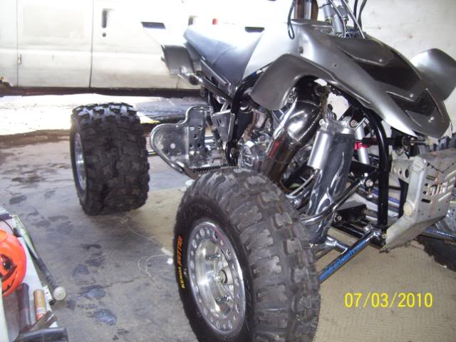

heres a pic of mine...i had no prob mounting it up front..i went thru the top bumper mount hole
blasterfreak, that is where i'd love to mount it but it looks like you're running aftermarket plastics and no light. I'm running stock and there is no room between the plastic which drops pretty low and the front bumper.
