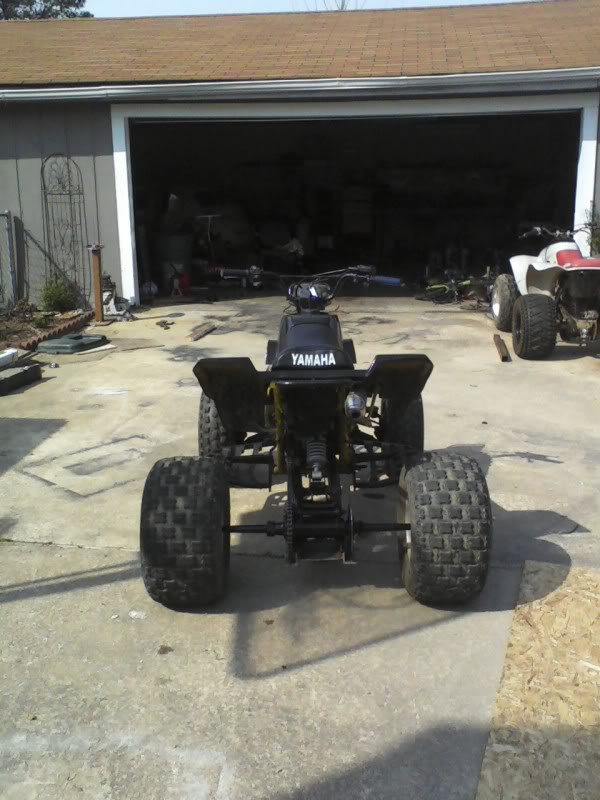

I traded an '87 250x for a 01 Blaster..
The blaster was in need of some help when I got it.It ran great but didnt look to good.. The frame was painted yellow,well really EXERYTHING was painted yellow,including the chain! Except the plastics were blue..Seat was torn and it had really ugly tires on the back..
It was all stock except for FMF exhaust and the nerf bars..
I painted all the plastics black and cut the front fenders down..Painted the a-arms,nerfs,bumpers and swing arm black too.. Stock shocks were painted silver..
I stripped all the black paint off the FMF head pipe down to bare metal and used several thick coats of high temp clear to seal it..
Also added a new chain,+4" swing arm,Boysen dual stage reeds,uni filter and got the jetting squared away.. New seat cover as well.
The rear was widened using Honda 250x hubs and 250x offset wheels,made it just over 46" wide,front is just flipped stock wheels..
Thats about all I can think of,sorry so long.. Here are some pics..
Before:
After:
I just got another one,so this ime I thought Id make an introduction.
Before:
After:
