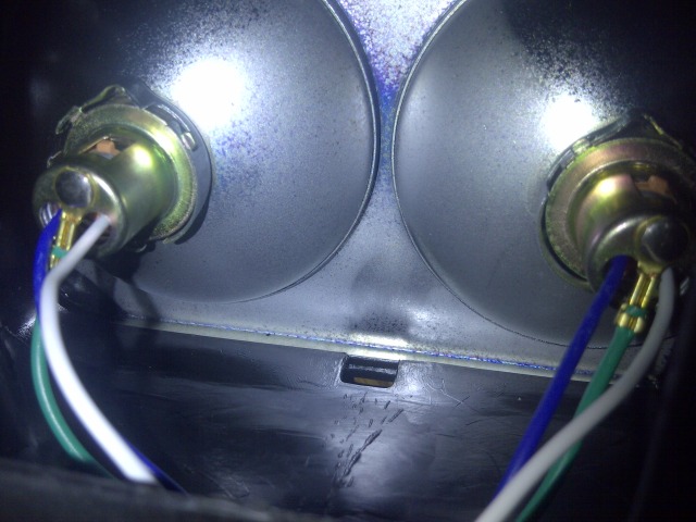

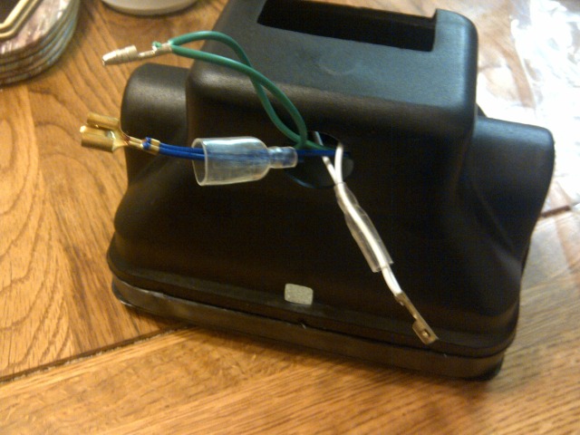

ok i bought a new headlight and it arrived today and it has white blue and green wires and i dont know which wires goes to where please help!
No instructions on the wiring? I would assume green is ground, White is low beam blue is high beam, But you have two lights so I bet the blue and white together connected to your stock headlight wiring will do the job! Green i think is low beam on our blasters and brown is high beam.
On a Blaster , green is low beam, yellow is high, black is ground.
As on your lights green is communal it will be ground.
Your connections should be, Blaster colours first.
Black to green.
Green to white.
Yellow to blue.
As the new light is a twin, check that both lights together draw no more than 40 watts!

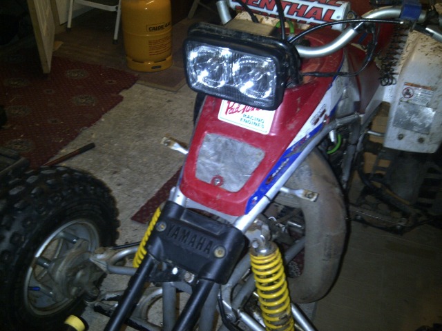

i have the light all wired up and looks sweet its a bit dim because i have 2 25w 6v - 12v bulbs in it and i took one out so theres just one 25w in it and its bright as **** will this be okay ? can i but 2 15w bulbs like these there the exact same, would this make it really bright so i can use the 2 sockets MOTORCLYCLE HEADLIGHT BULB LAMP 12V 15W PX15D 1038 | eBay
here is a pic of the light, i had to use a jack to widen the bracket as the light was a cm to long to go on the bracket...
