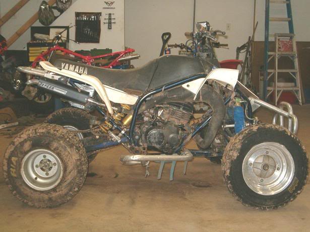

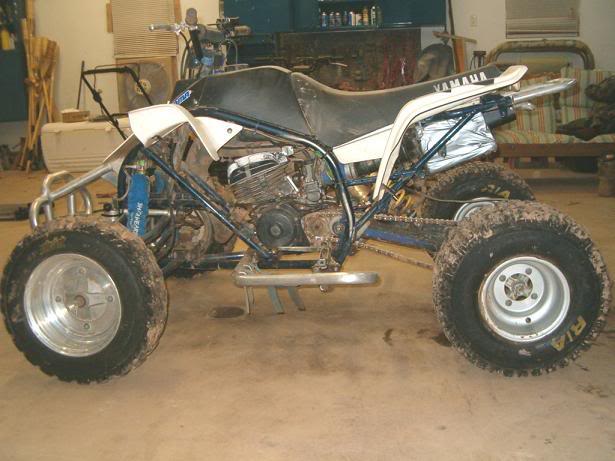

All you need are Ken O'Connor's bushings and/or your own bushing to put in place and then drill out the bottom shock hole on the shock with a 12mm bit. I used a 15/32" bit I picked up at Lowes for $8 and it worked fine.
how the hell do u have a banshee shock on a +2 swinger?
assuming your talking to me...its a +3
