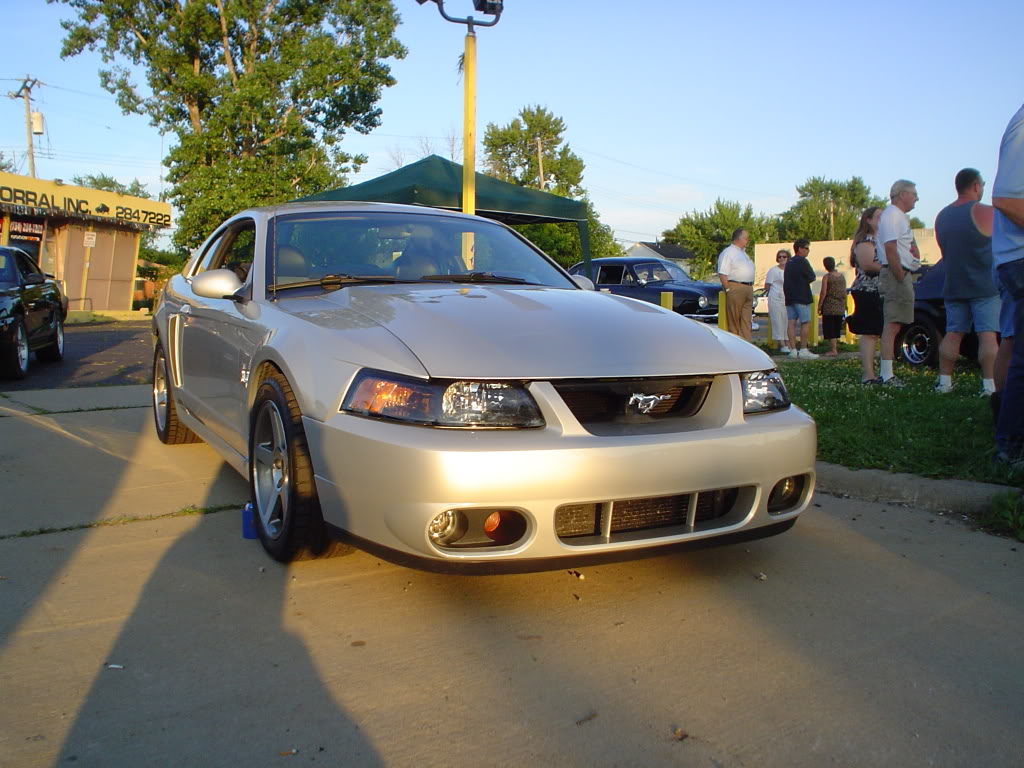

Yup, its a supercharged 2003 SVT Cobra. The fox is an 86. The engine in that pic is a 351W bored and stroked to 393. I have since sold that engine and have been (slowly) building a new one. New engine will be 406 cubes and make about 200hp more on motor than the 393. Shooting for 9's on motor and 8's on one stage of nitrous.

The Cobra:

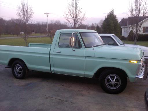

To the OP can I see a pic of your pickup ? I love the late 60s early 70s trucks. Here's mine.

VERY NICE TRUCK!! yeah i love them too, i currently do not have pics and the truck is at my Granny's (an hour and a half away), i will get some whenever i'm back down there. i might go this weekend. it will not be in it's current body for long though due to the legal issues i will be taking the 351 cleveland and tranny out and putting in another body. i was looking at 80's mustangs but that would be too much trouble but now i have found a 78 f100 body i'm looking at, may end up going with it. mine is red and white and the interior is red, but the 78 body i'm looking at is blue and needs the interior put in and he doesn't have pics of what the interior looks like.

nice!!! i love cobras my favorate cars ever made!!! i will own one someday.
any mods done to your's ?
my friends dad has one with a 2.7 supercharger pulley cat back cai and a tune silver one like your's, cant help but drool everythime i see it.
