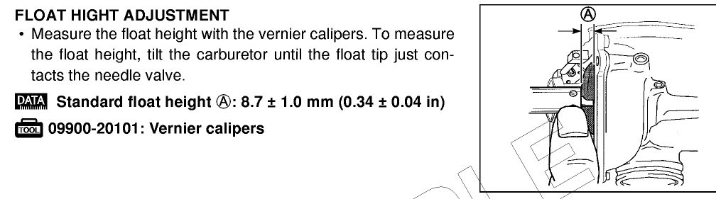

Well the float isn't adjusted right, and it could be filling your bottem end up with gas and flooding it. Take the plug out and kick it over a bunch. It will clear the gas if that's what's happening.
I googled yz125 Float height. It didn't say a year though.
tools:
screwdriver
caliper (or something that measures to at least .1mm)
take off carb, take off the float cover
measure like the picture above says
Calipers are about the only thing you can use. Or a steal machinist rule with metric ruling on it.
