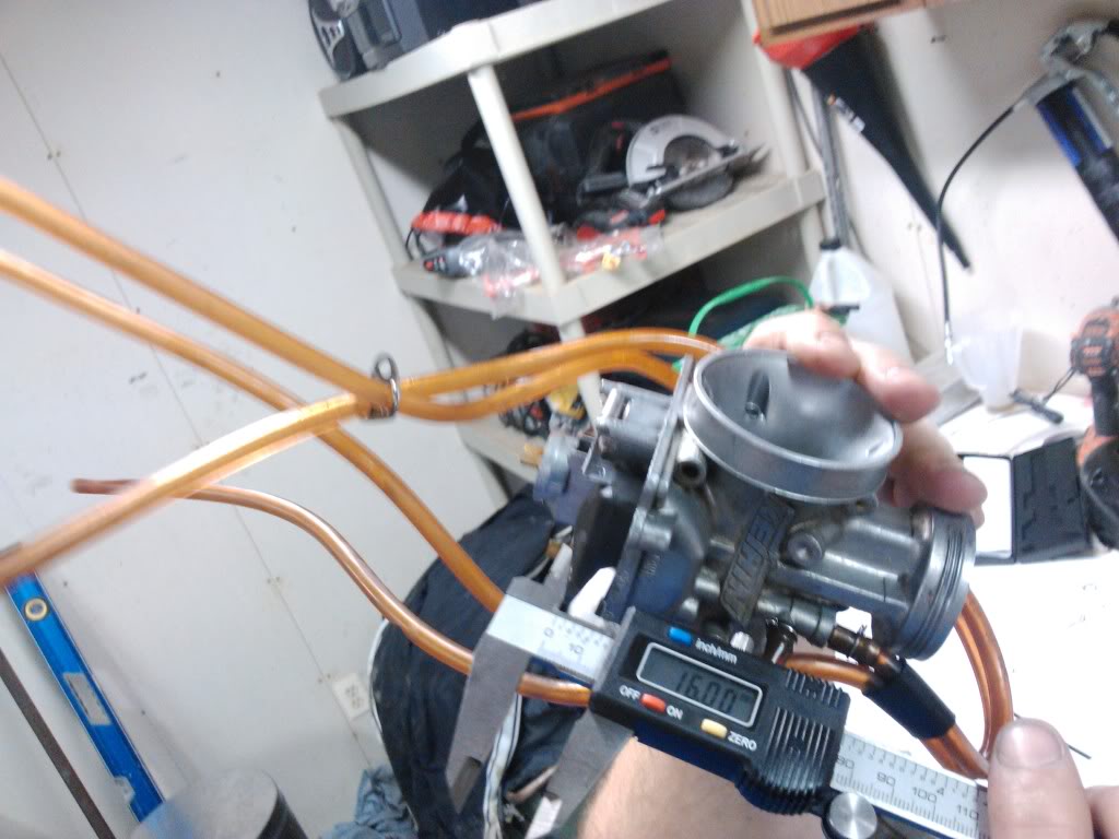

That's the picture I found. So here's the update. I used the lines as a guide and set to 16mm at a rested position. Fired it up with the 52 pilot. Highest idle was 2.5 turns out. I could just put a 50 in there but I don't think that will solve my problem. So I took it for a quick cruise at 1/4 and 1/2 throttle. Cel needle 2nd clip. It was still really rich. I think my float is causing it to be rich. I have a dgh needle too, but that will make it even worse. A new float is only 20 bucks. I can either order a float or set the float at 17mm and see if it leans it out some. The fact that I am at see level doesn't make any sense. I appreciate the help AWK.
My float looks different than that one. That one looks like the one on my kx250. I am trying to upload a pic where I was measuring the float height.

I am measuring the highest point on the float. Once this picture uploads I will post it. Well if the dgh needle is leaner that may be the fix. I always read its a richer needle. I'll throw a 50 pilot in and dgh in middle slot and post results.

So here is where I am. I bent the float back to exact measurements of the float on my kx250 (38mm pwk) I put the 50 pilot in and fired it up. I didn't sound like a four stroke anymore! Finally had some pop to it. Air screw is at 1.5 turns out. I still have the cel needle in and haven't tried it since the float is fixed. It's in the 2nd slot now. I will try that tomorrow. If I can't get it smoothed out with that needle I'll throw the dgh in there. Then on to the easy part, the plug chop. I'll let the plug be a taddle tail and should be good to go. Hopefully the b8es will show more color than the b9es. I did a plug chop last time with a 158 and there was hardly anything on the plug. I went 1st through 6th WOT. this was after it passed an leak test. Any more advice? Thanks for all your help!
