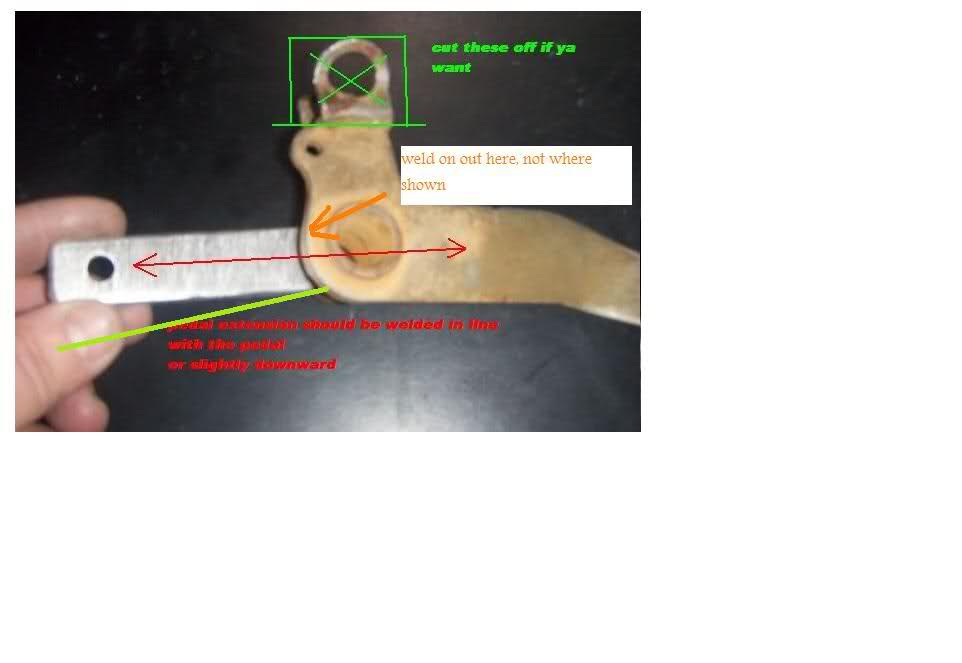

I got the tab from awks brake kit just lazy. I was going to try and find one to just bolt on. I got a welder to do. Just trying to save a little time. Thanks for the reply.
the tab on an 03+ is not long enuf to reach where the master is gonna line up on my bracket, mine will bolt on an angle and 03+ ones sit almost straight up and down, < i believe, just weld the tab i sent you to the pedal, on a slight angle down ward, heres a pic, but since taking this pic i've found it works better to weld it slightly downward and leave the rod longer on the master
disregard the original red line i was welding them on, more like the green line on that angle......................
