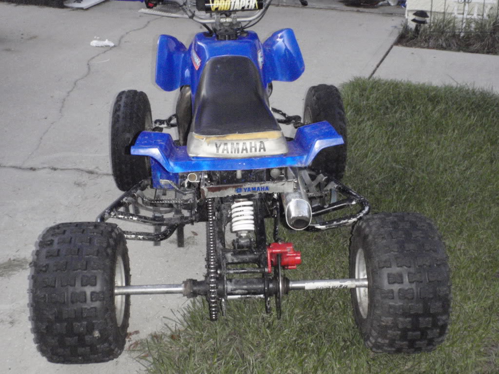

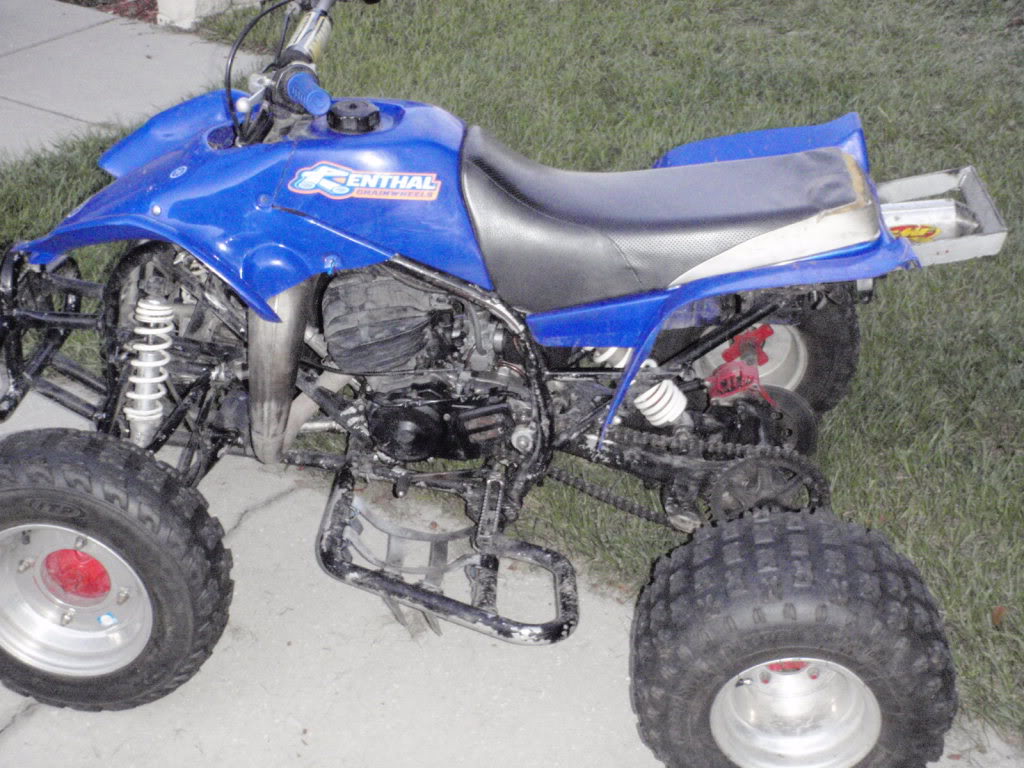

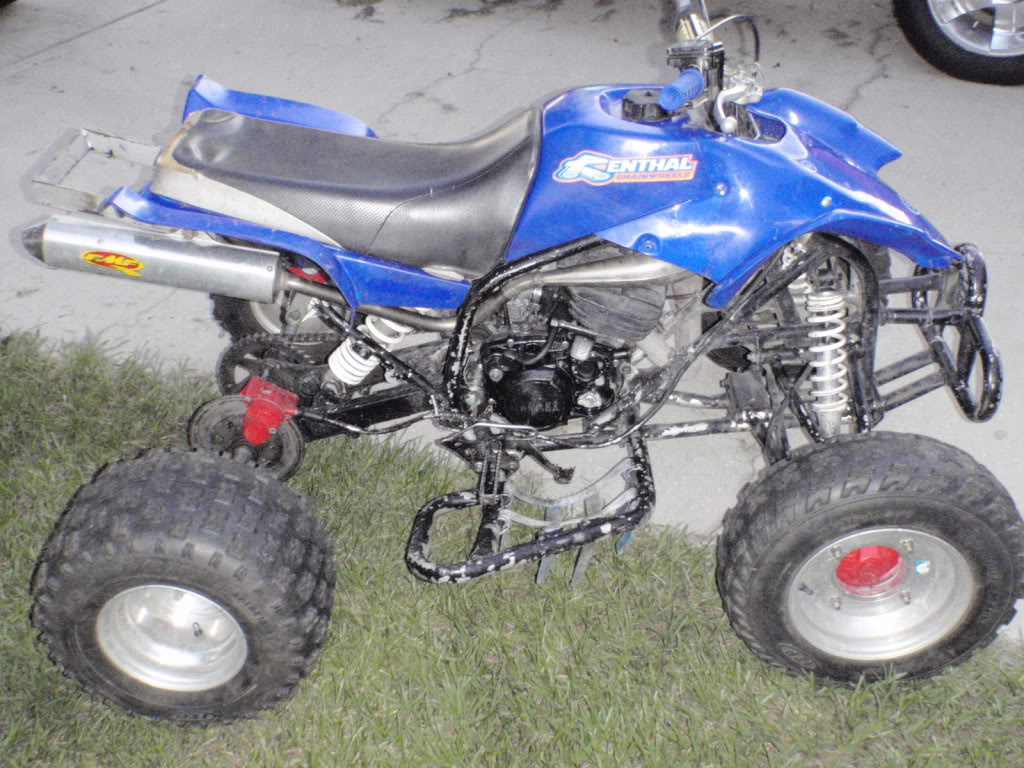

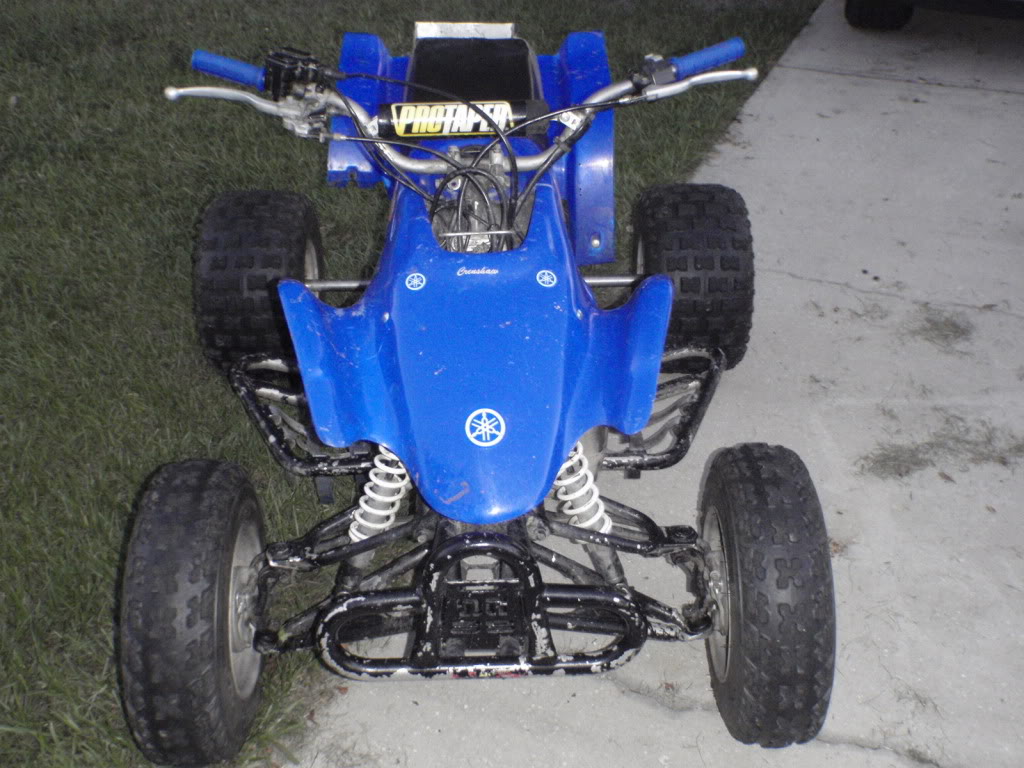

I did some of what I do best and traded a few things for this 02 blaster to ride until I get my motor back from ken.
From what I can tell the motor is stock with a riva racing fmf pipe. I beleave it has a wider rear axle made by dura blue, douglas rims ,itp hole shots, dg front bumper ,nerf bars,and I think pro taper bars.
Actually a pretty good bike. Got quite a few mods to it and besides the paint chipping and it needing a good washing, its in pretty good condition. Cool find, what did you end up trading for it?
