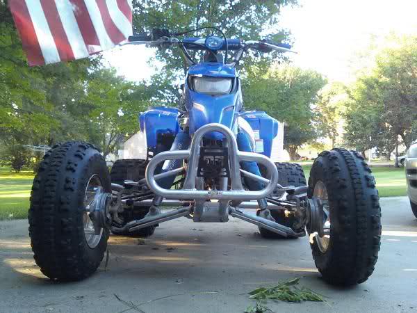

This is why things like extended A-Arm kits and front wheel flipping, etc, are so much more popular and definitely recommended as the procedure to follow, to get a wider front end on an ATV. I personally chose a much cheaper route than doing a FULL A-Arm upgrade, etc, and still got a full 8 inch stretch over stock. I used a product from Diamond J, their A-Arm extension kit. This kit basically re-locates all the mounting points for your stock equipment, widening each side 3 inches. The braces/brackets are heavy duty and super strong, race proven and actually much nicer than I anticipated on them being. They can be painted and customized to match your bike, etc, as well...
There are 2 kits available, a 4.5" and a 6", I went with the 6". Between this kit and a front wheel flip you are 8" over stock on the blaster, how can you beat that utilizing all of your stock suspension components, still leaving room for future upgrades if desired, all for under $200???
Brilliant, Just thought I would share this with you guyz/galz...
