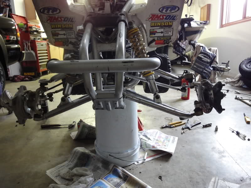

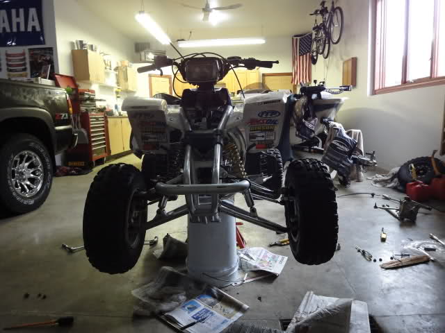

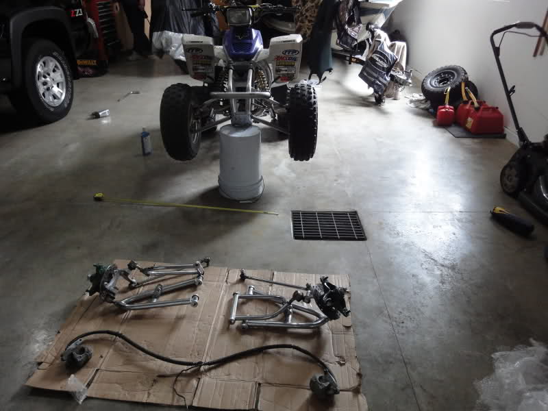

Well I finally got home to put on my new front a-arms and hydro brakes. They are Burgard +2 +1 chrome arms, and banshee/YFZ front hydros/master cylinder. I also got my new Hiper racing CF1 front rims on. Here are some pics.

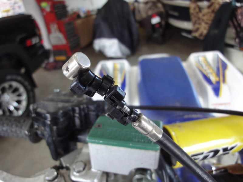

And here is how i n*er rigged my rear brake to work just for a little ride haha
Im very happy with them. They make the shocks softer which is nice. Overall installation wasnt bad, but I ran into a few unexpected issues. To get the tie rods off the steering stem we had to take a torch to the stem and pry them out. On the lower arms to get the front bolts off I had to take off the bumper. And for the rear bolt on the exhaust side of the lower arms the bolt hit the pipe before it came out, so I basically had to take apart the complete exhaust to move the expansion chamber enough to get the bolt out. Other than that it was all good though.

Thanks, when I get out of school (May 13ish) I wanna paint the front hubs yellow along with a few other things, and wash it. Here is a pic of the new rims/ tires. I think It will look sweet with the yellow hubs in the front, with the beadlock rings on the back.
Thanks. I was pretty pumped to get them on, I think it looks mean, low and wide.
