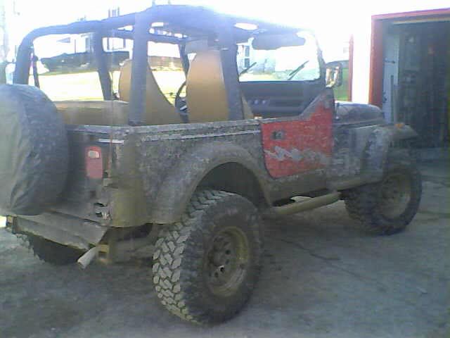

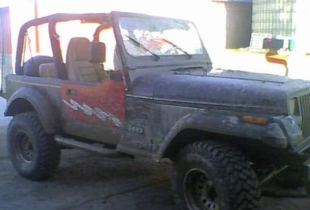

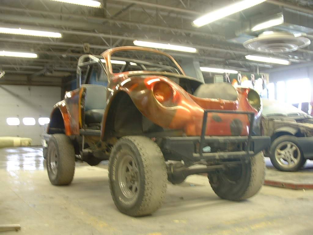

heres the mudd bug our auto body classs was working on for a couple years now,

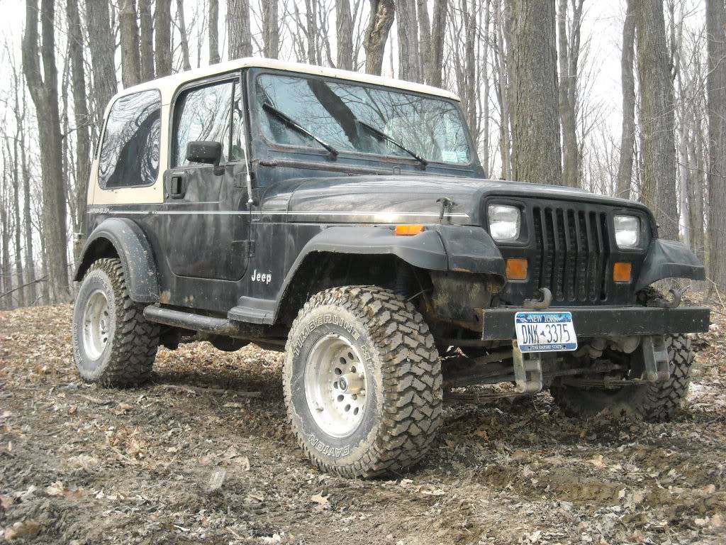

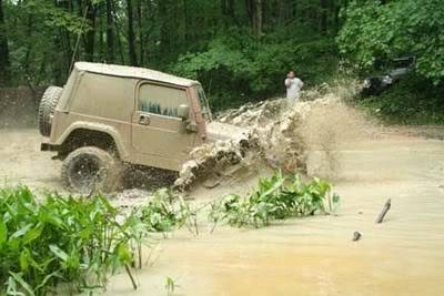

I will Take my Toyota Turbo Diesel 4Runner over a Jeep anyday. These pictures were of m,y las outing I hit a hidden stump and spun two tires off the rims I went from 33's to a 15 inch tire as a spare lol.

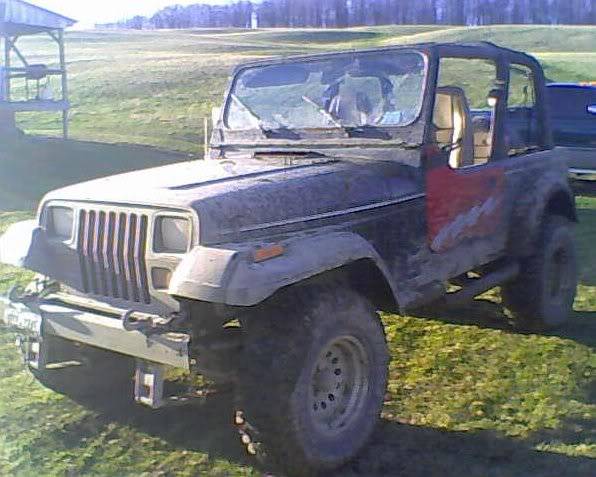

Here's my rig for now...
2" 4wdHardware coil lift
33x12.5 Pro Comp MTs
Warn RC bumpers front and rear with custom swing away tire carrier
winch, skid plates, high lift, etc...
Eventually I want to go bigger, but I'm content for now. I actually downsized to 30x9.5 BFG AT KOs for the street so I could stop chewing up my MTs on pavement.

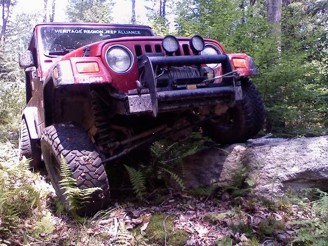

Oh, and cuz I know everyone here are pic whores, here's some action shots:
CJs with suspension upgrades are amazing machines...
Here's one of a guy's I wheel with, with custom suspension mods:
