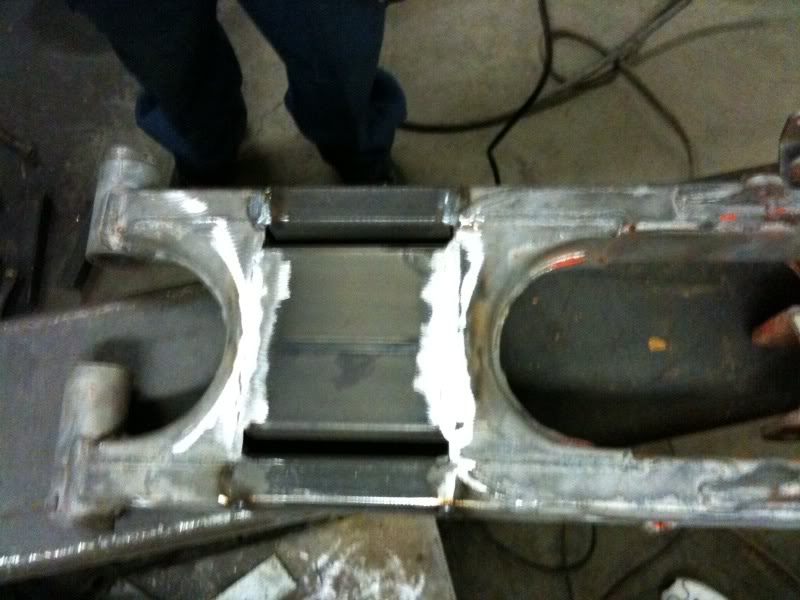

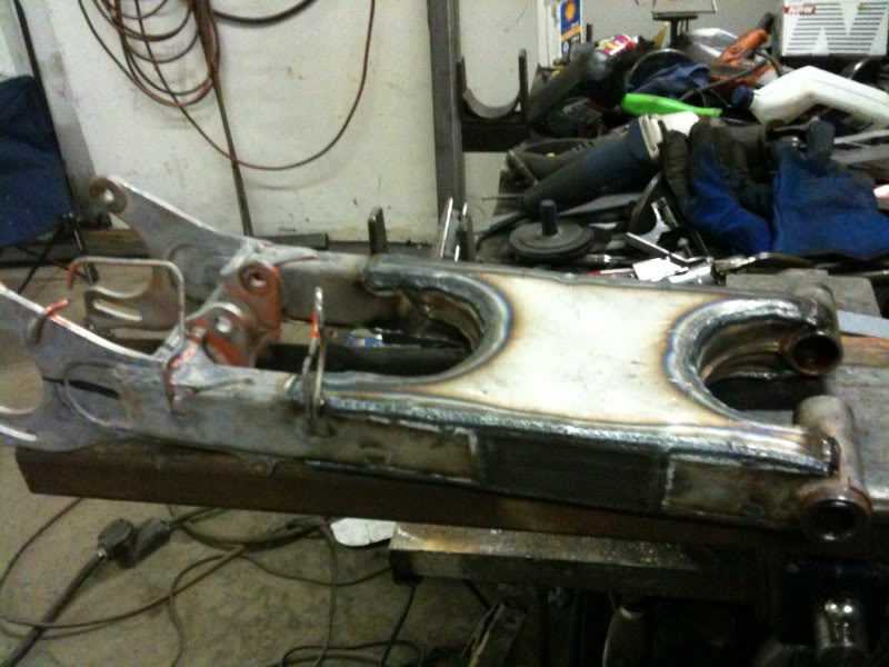

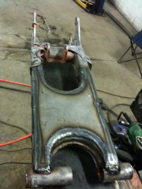

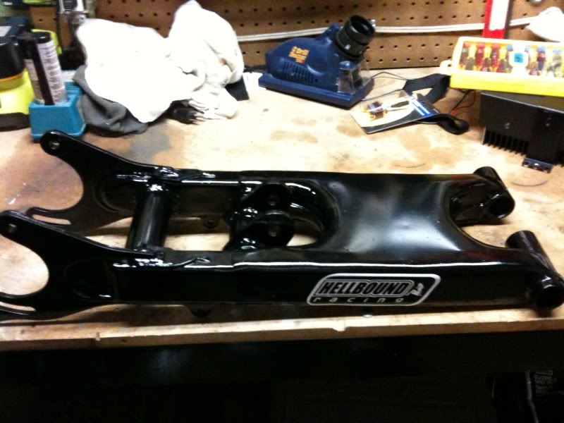

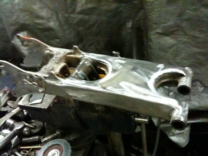

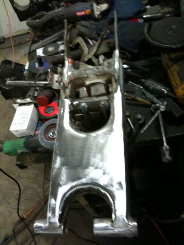

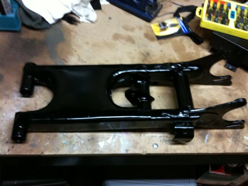

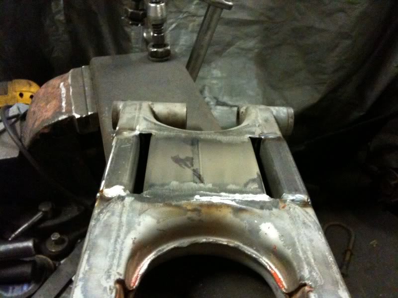

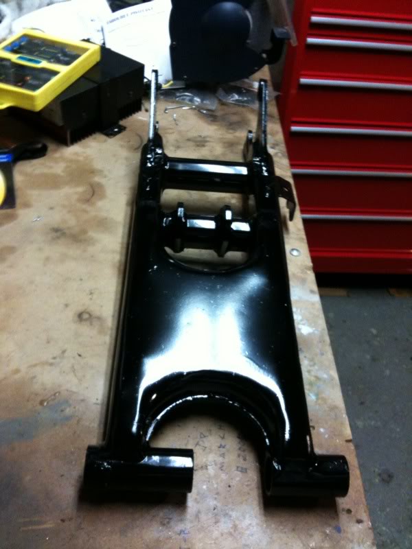

hey guys, thought you might like to see to my +4 swinger that a friend welded up for me.
we used a piece of 4x2 box tubing in the center and 2 piece of 1x2 box tubing on the outside.
then we plated the top and bottom with flat steel.
for the shock mount we used some 4 link tabs he had lying around and we mounted them to a piece of DOM 1/4 tubing that we also used to replace the stock shock mount.
let me know what you all think.
sorry for the crappy pix, there from my phone.
i think you did a bahttp://www.blasterforum.com/images/icons/icon12.gifd ass job i like it.theres a few people that make there own on here and i think ithis is the cleanest one ive seen so far.good job
you haven't seem mine ;)
Anyways it looks like it'll be strong, and i like the way you extended it in the middle of the cross brace good work.
