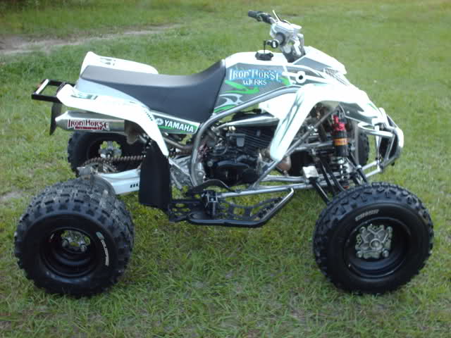

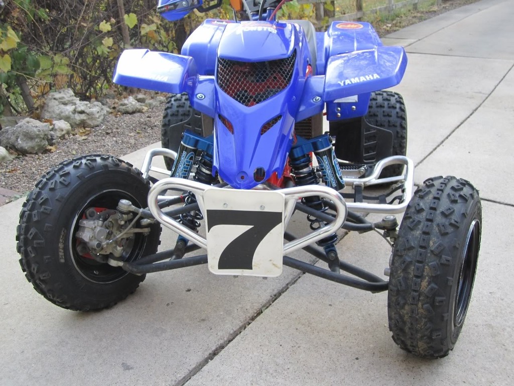

2006 Yamaha Blaster
A Arms: 3+1 American Star Long Travel Shock A-Arms
Swingarm: American Star +4 Long Travel Roundhouse swingarm custum built LT
Steering Stem: ROLL DESIGN anti vibe +1 Steering Stem
Stabilizer: Gibson Stearing dampner
Axle: DuraBlue extended Axle
Carrier: Roundhouse American Star
Locknut: DuraBlue
Hubs F|R: Stock 06
Bars: Fasst Flexx Bars with anti vibe dampeners
Throttle/Clutch Lever: Moose Billet Thumb Throttle , ASV levers
Grips: Pro grip
Nerfs: AC Racing custom heal guards
Bumper: DG National Series Front Bumper
Grab Bar: DG National Grab Bar
Front Shocks: 16" Triple Rate elka LT shocks/remote rezzi dual adj.
Rear Shock: 16" Elka long travel dual rate rezi shock
Brake Lines: Lt Steel braided
Rotors F|R: Stock
Rims F|R: Douglas bead lock rims
Tires F|R: hole shot front / Maxi Razor
Body:
Frame: Rath racing gusset
Plastic: Project blaster green race plastic, Project blaster vented race hood
Graphics|Seat Cover: Kruz Racing Team / Gripper Seat cover
Number Backgrounds: n/a 009
Handguards: n/a
Bar Pad: fasst flexx
Fuel Tank: stock and moded fuel valve and project balster cover, Gas cap carbon fiber
Engine|Drive System:
Cylinder|Head: 200cc AMA legal motor Factory 7 Fire-Breather 200cc Cylinder Kit. Milled head runs only 110 race fuel
Bore & Stroke: Standard for AMA "Hot Rods" crank
Displacement: Standard for AMA
Cam: n/a
Carburetor: Trenga racing 30mm flatslide carb, 1/2" reed spacer, Boyesen power rad valve supercross, v-force 3 reeds AMA,
Air Filter|Box: Project Blaster Factory Aluminum Airbox
Pipe|Silencer: "Factory7" pipe /"LRD"silencer and also PSI for AMA
Clutch|Plates: Barrenet clutch kevlar will moose heavy duty springs
Gearing F|R: 13/40 13/41 /13/42 13/43 14/40 14/41 14/42 14/43 based on track
CDI|Killswitch: Notrology hot wire, Notrology coil, Pro Armor tether
Cooling: air Project Blaster air scoops
Other: lightend flywheel, 4 deg. timing advance

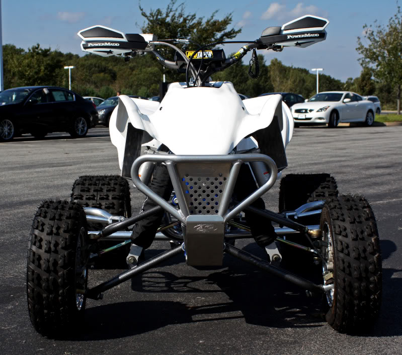

A Arms: +4+1 atvfourplay long travel
Swingarm: +3 atvfourplay round housing
Steering Stem: stock
Stabilizer: none
Axle: DuraBlue eliminator extended Axle
Carrier: Roundhouse fireball racing
Locknut: DuraBlue
Hubs F|R: Stock 04
Bars: stock
Throttle/Clutch Lever: stock
Grips: stock
Nerfs: xfr pro peg
Bumper: xfr jaws
Front Shocks: 19'' triple rate custom axis w/ adjustable comp & rebound
Rear Shock: single rate custom axis w/ '89 trx250r spring rezi shock adjustable comp & rebound
Rotors F|R: Stock / Saw blade rear
Rims F|R: Douglas aluminum / beadlock rears
Tires F|R: hole shot front / turftamer rear
Body:
Frame: stock powdercoated blue
Plastic: maier race front / stock rear
Graphics|Seat Cover: stock / stock
Number Backgrounds: k&k racing
Handguards: n/a
Bar Pad: none
Fuel Tank: stock , aluminum Gas cap
Cylinder|Head: vito's 240 / modded head
Bore & Stroke: 72mm bore 60mm stroke
Displacement: 244cc
Cam: n/a
Carburetor: keihin 35mm airstryker, reed spacer, v-force 3 intake
Air Filter|Box: uni / cfm aluminum airbox
Pipe|Silencer: dyno port high volume
Clutch|Plates: ebc clutch kit
Gearing F|R: 14 / 38
CDI|Killswitch: stock / pro design tether
Cooling: cfm air scoops
Other: 4 deg. timing advance, billet aluminum rear brake rezzy, works connection frame guards, modded & chromed kickstart, T.M. Designworks aluminum stator / oil injection covers, completely polished engine

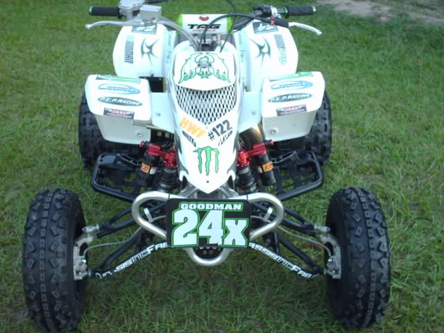

1. A Arms: burgard +2+1
2. Swingarm: SMS +3
3. Steering Stem: janseen +1 anti vibe
4. Stabilizer: none
5. Axle: G-force
6. Carrier: SMS round housing
7. Locknut:G-force
8. Hubs F|R:stock | aftermarket, but not sure what brand.
9. Bars: pro taper contour
10. Throttle/Clutch Lever:stock | F7
11. Grips: pro taper pillow tops
12. Nerfs:graydon proline
13. Bumper:tusk comp series
14. Grab Bar:stock
15. Front Shocks: internally shortened yfz (stock shock length)
16. Rear Shock:re-sprung z400 (thats why the spring is blue)
17. Brake Lines:burgard
18. Rotors F|R:stock
19. Rims F|R:itp reinforced | itp beadlocks
20. Tires F|R:itp holeshots | itp quadcross MX pro
Body:
1. Frame:stock
2. Plastic:blue maier vented race front
3. Graphics|Seat Cover:stock
4. Number Backgrounds: none
5. Handguards: none
6. Bar Pad:none
7. Fuel Tank:stock
1. Cylinder|Head:extreme ported | milled
2. Bore & Stroke: stock
3. Displacement:stock
4. Cam:?????
5. Carburetor:35mm airstriker
6. Air Filter|Box:UNI | CFM
7. Pipe|Silencer:factory 7
8. Clutch|Plates:not sure what brand.
9. Gearing F|R:14/38
10. CDI|Killswitch:stock | pro armor tether / yz style kill button
11. Cooling:air???
12. Other:vito's reed spacer, V-Force 3 Reed Cage, wiseco piston, vito's oil block off, adjustable ignition stator, Pro Design intake,

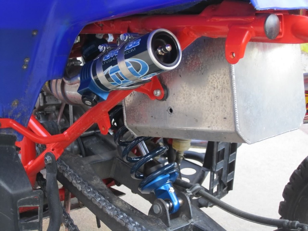

A Arms: stock with diamond j +6 widening kit
Swingarm: +3 extended f7
Steering Stem: stock i think
Stabilizer: none
Axle : gforce adjustable axle
Carrier: gforce
Locknut: gforce
Hubs F|R: hydraulic/yfz450
Bars: renthal
Throttle/Clutch Lever: stock/stock
Grips: scott grips
Nerfs: tusk
Bumper: ac
Grab Bar: baja rear grab bar
Front Shocks: yfz450
Rear Shock: modded rear
Brake Lines: stell braided
Rotors F|R: stock
Rims F|R: itp/itp baja
Tires F|R: itp holeshot/r/a shredder
Body: maier race front hood/cut rear fenders
Frame: stock and fully gusseted
Plastic: maier race hood
Graphics|Seat Cover: none but stickers/05 seat cover
Number Backgrounds: custom on the front hood
Handguards: acerbid
Bar Pad: outlaw
Fuel Tank: stock
Cylinder|Head: vitos 240 bbk
Carburetor: keihn 35mm pwk
Air Filter|Box: twin air filter/sms aluminum airbox
Pipe|Silencer: fmf all the way
Clutch|Plates: barnett dirt digger clutch/trenga racing side cover
Gearing F|R: 13/43
coil|Killswitch: aftermarket coil/pro design killswitch
Cooling: air
Other:18 rear tires doughlas rims and pro circuit exhaust/works shocks/banshee axle/trenga racing hydraulic rear brake/fox racing air shrouds and oil injection delete/trenga cylinder/sms manifold reed spacer/boyessen pro series reeds/scary fast not installed/baja skid plate front and rear monster shock covers on the way fully gusseted frame.
all my spec are in my Sig... not much, but im getting there, im getting the tusk comp front bumper soon.... last pic is what it looked liked when i bought it in October 2011

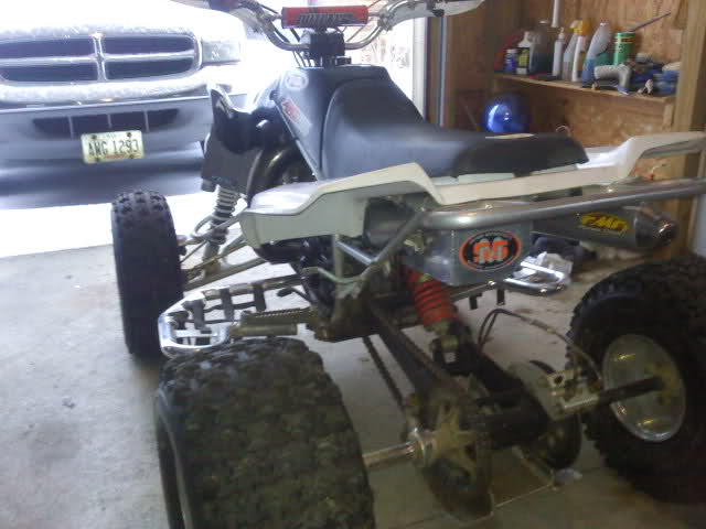

A Arms: 3+1 SMS LT
Swingarm: Stock
Steering Stem: Stock
Stabilizer: None
Axle: RPM Dominator II
Carrier: RAD tappered
Locknut: RPM Loc-Nut
Hubs F|R: Stock 04
Bars: Pro Taper Contour
Throttle/Clutch Lever: Stock / ASV F3/ ASV Pro-Clutch
Grips: Renthal Kevlar
Nerfs: AC Racing
Bumper: AC Racing
Grab Bar: AC Racing
Front Shocks: Stock YFZ 450
Rear Shock: Works Remote Res. Quadstar
Brake Lines: Galfer/ StreamlineLt Steel braided
Rotors F|R: Stock with Galfer pads
Rims F|R: Douglas .190
Tires F|R: MXR6
Body:
Frame: Stock
Plastic: Maier Race Hood, Maier tank guard, Maier rear plastic
Graphics|Seat Cover: FX Gripper
Number Backgrounds: None
Handguards: PowerMadd
Bar Pad: ProTaper
Fuel Tank: Stock with banshee petcock, tusk billet cap
Cylinder|Head: +3 mid-top KOR, KOR rechambered head for race gas
Bore & Stroke: .040 over +3mm stuffer
Displacement: 209?
Cam: n/a
Carburetor: 35mm PWK AS, VF3, Pro-Design reed spacer
Pipe|Silencer: DynoPort mid-top
Clutch|Plates: Barrenet clutch kit / Hinson basket
Gearing F|R: 14/ 39
CDI|Killswitch: Pro Design tether
Cooling: Project Blaster air scoops
Other: lightend flywheel, 4 deg. timing advance, shift star mod,
Not really a real MX blaster just something made to have fun on while having a decent suspension and some pep

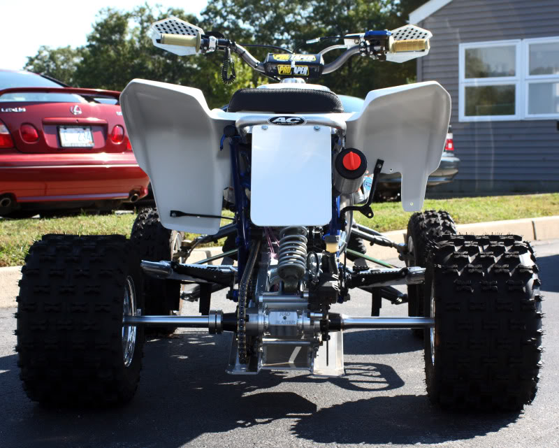

A Arms: Burgard +2+1
Swingarm: Snyder Motorsports +3
Steering Stem: Burgard Standard length
Stabilizer: Janssen Stick
Axle : G-force
Carrier: Snyder Motorsports
Locknut: G-force
Hubs F|R: Stock
Bars: ATV Four-Play Soft bars
Throttle/Clutch Lever: Stock / Asv unbreakable
Grips: Pro taper Pillow tops
Nerfs: Jardine
Bumper: Tusk
Grab Bar: Stock
Front Shocks: Motowoz
Rear Shock: Motowoz
Brake Lines: Burgard steel braided
Rotors F|R: EBC
Rims F|R: ITP reinforced / ITP beadlocks
Tires F|R: ITP Holeshot / ITP quadcross mx pro
Body:
Frame: Gusseted
Plastic: Stock / Cut front fenders
Graphics|Seat Cover: N/A
Number Backgrounds: N/A
Handguards: Factory 7
Bar Pad: ATV four-play
Fuel Tank: Stock
Engine|Drive System: 2004 YZ85
Cylinder|Head: Ported / milled
Bore & Stroke: idk
Displacement: 90cc
Cam:
Carburetor: 28mm something lol
Air Filter|Box: UNI / CFM aluminium
Pipe|Silencer: FMF fatty
Clutch|Plates: EBC

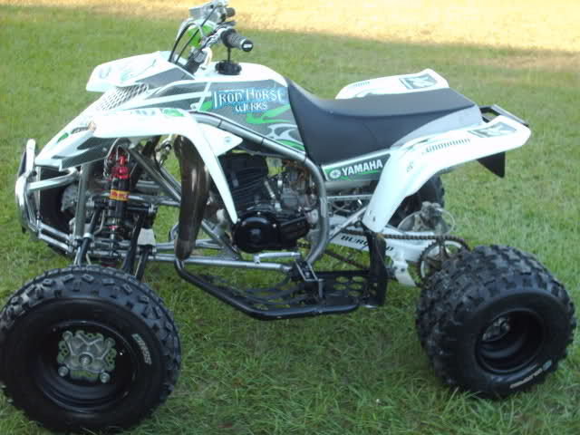

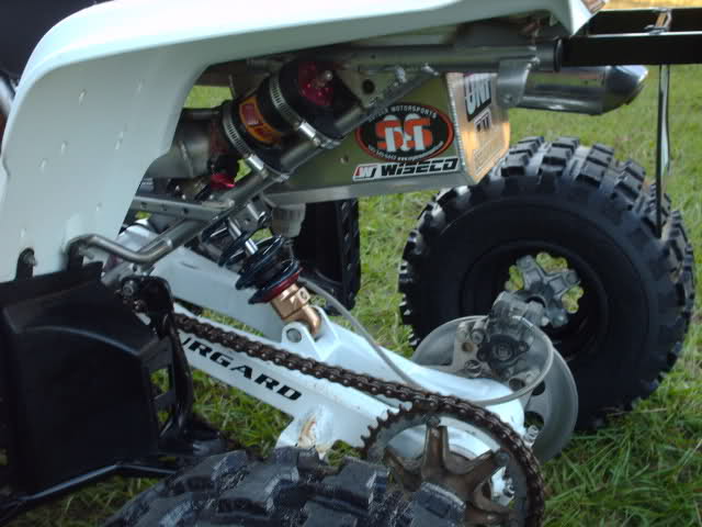

Gearing F|R: can't remember...
CDI|Killswitch: Stock / pro armor
Cooling: Yamaha yfz450 rad
Other: Lots....
A-arms: ChassisIncFAB custom MGC +4+1
Swingarm: Burgard +2
Steering Stem: stock with ROX +2 risers
Stabilizer: Streamline 7 rebuildable
Axle : G-Force
Carrier: JJ&A billet
Locknut: G-Force
Hubs F|R: front YFZ450, rear blaster splines but 4/110 pattern
Bars: TAG
Throttle/Clutch Lever: stock throttle, MSR clutch lever
Grips: ODI locking grips
Nerfs: Pro Aluminum Pro Pegs
Bumper: Tusk
Grab Bar: Snyder Motorsports
Front Shocks: ELKA Elite Stage 4
Rear Shock: ELKA Elite Stage 4
Brake Lines: streamline stainless (twin lines in front)
Rotors F|R: stock rear(for now) yfz450 fronts
Rims F|R: G-Force black
Tires F|R: Fronts=RazR Cross 20x6-10, Rears=DWT Goldspeed MXR 18x10-8
Body:
Frame: full gusset kit
Plastic: stock
Graphics|Seat Cover: custom sponsor graphics, stock seat
Number Backgrounds: 3color white, black, green on black plates
Handguards: none(soon to be powermad)
Bar Pad: TAG 1 1/8" fat bars cr low bend
Fuel Tank: stock
Cylinder|Head: Airsal 200 cylinder ported by RTR head cut down for squish and compression
Bore & Stroke: stock 200cc legal AIRSAL motor ported
Displacement: 200cc
Cam:
Carburetor: Keihin PWK 33
Air Filter|Box: CFM aluminum
Pipe|Silencer: FMF Fatty w/power core silencer shortened
Clutch|Plates: Driveline HD
Gearing F|R: 14/40, 14/38
UPDATE:
A Arms: Stock
Swingarm: Stock
Stabilizer: none
Axle: Stock with +4 stud spacers
Carrier: stock
Locknut: stock
Hubs F|R: stock
Bars: stock
Grips: Scott
Nerfs: Tusk Comp Series
Bumper: Tusk Comp Series
Grab Bar: Custom by me
Front Shocks: Stock (sadly)
Rear Shock: 400EX
Brake Lines: Stock
Rotors F|R: Stock
Rims F|R: Stock
Tires F|R: Stock Fronts/Artrax MXT-R Rears
Body:
Frame: Stock
Plastic: Stock
Graphics|Seat Cover: Stock
Number Backgrounds: Plain white
Handguards: None
Bar Pad: Renthal
Fuel Tank: Stock
Cylinder|Head: Stock
Bore & Stroke: .30 Bore
Displacement: 197cc
Carburetor: Stock/ Boysen Super Stock Carbon Reeds
Air Filter|Box: UNI
Pipe|Silencer: FMF Gnarly Pipe/ FMF Powercore 2 silencer
Clutch|Plates: Tusk Clutch Kit
Gearing F|R: Stock
Cooling: None
Other: Fliped front tires/ Open airbox
6498-tusk-comp-bumper-400ex-rear-shock-custom-grab-bar-4-stud-spacers-renthal-bar-pad.jpg
6499-tusk-comp-bumper-400ex-rear-shock-custom-grab-bar-4-stud-spacers-renthal-bar-pad.jpg
6500-tusk-comp-bumper-400ex-rear-shock-custom-grab-bar-4-stud-spacers-renthal-bar-pad.jpg
