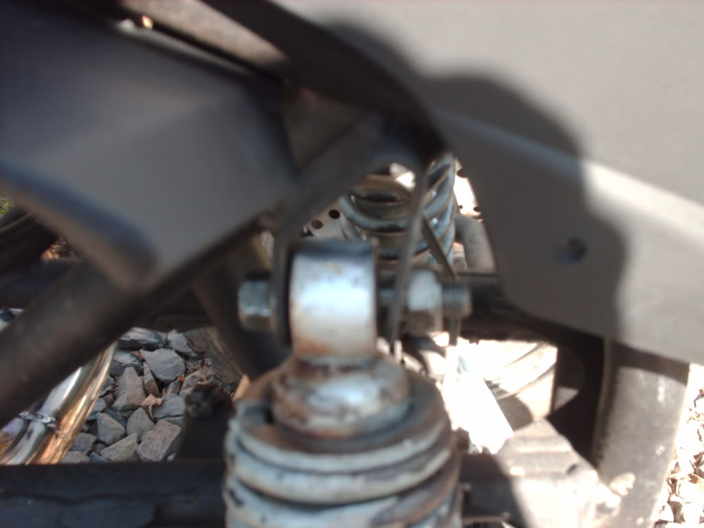

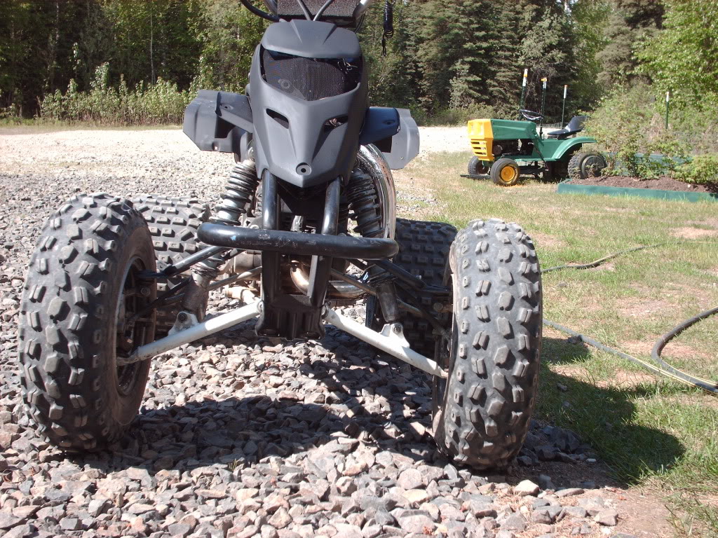

Heres some pics!
Keep in mind these are ugly as sin, I'll freshen them up.
(looks crooked because its stilling on a slope )

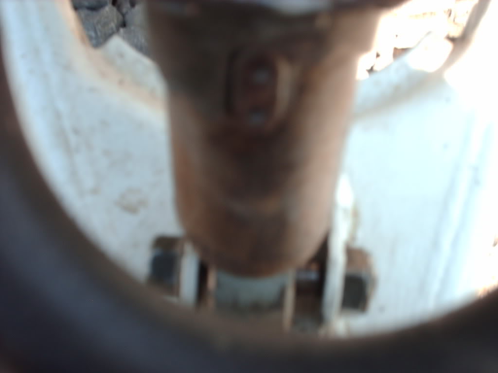

Heres why you need washers

One thing you will have to do is get some washers as the brushings are skinnier then the blasters. Other then that its very stright forward.
