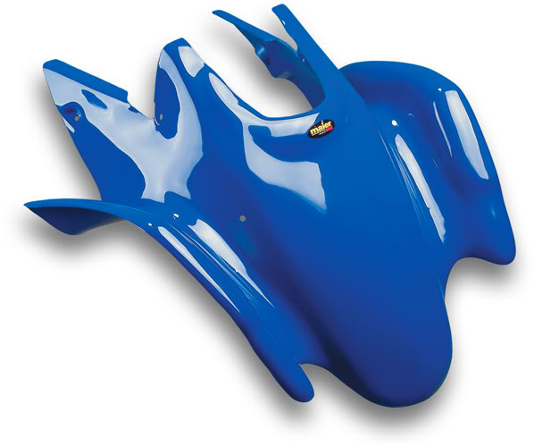

mair race fenders on 03-06 frame

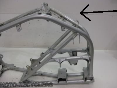

you guys sure, that thing on the frame looks pretty big.
Fenders i bought
02 frame. (no large protruding thing sticking up
06 frame that i want (thing sticking up)
Looking at my pre '03 with the race front mounted up, it looks like you should be alright. There is a lot of room underneath the plastic. It looks like the side of that bulky mount might bolt right up to the mounting holes on the side of the fenders. Dont quote me but you should be alright.
can someone measure the height of that on their 03-06, maybe i can get soemone thats put those on a 90-02 to see if its enough clearence. I supose i could just cute it out of the way if i had to.
It will fit. that i only to hold the headlight housing. i have it on mine and i have the maier plastics and they fit perfect.

i know you probably already have it on, but i think theres that part you were concerned with on an 88-02 but i think its more like a loop made of thin circular metal, and it keeps the clutch, brake and throttle cables in place. But i'm not positive.
