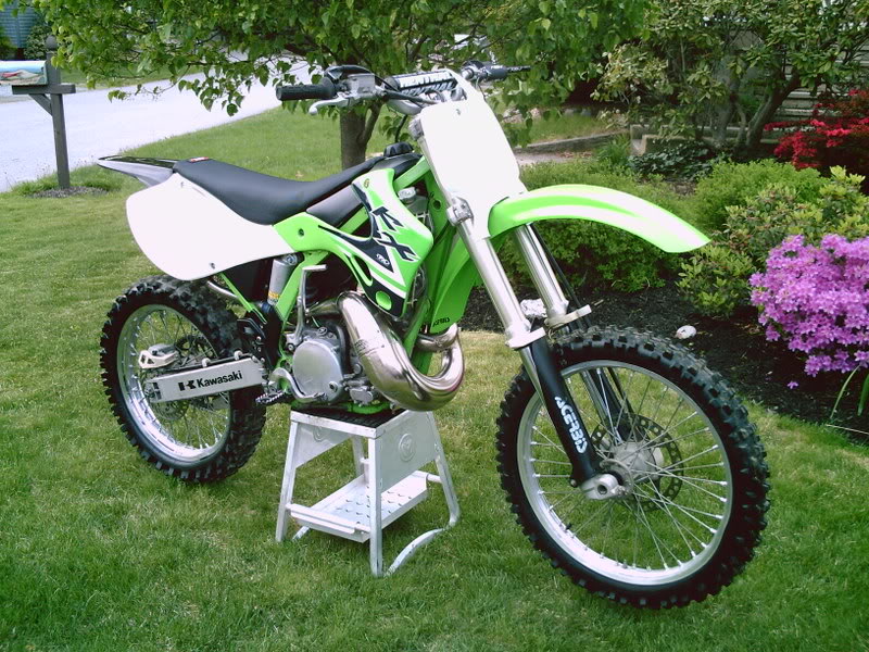

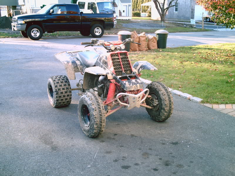

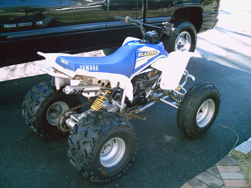

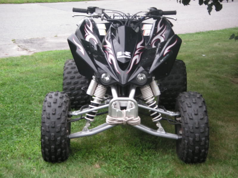

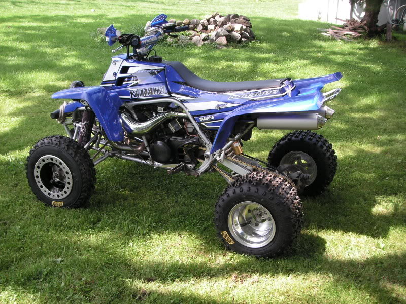

picsssss welcome back to the blaster scene
pics of my old bikes?
So right now my blaster is white with the red frame. Im thinking of having my friend paint the hubs/swinger/throttle plate yz blue, the frame/front bumper/a arms a gun metal color, and then keep the white plastics and a all black seat.
very nice toys, very clean....i guess the 2nd shee is your beater shee...and the first one is the show off/ duner shee LOL....very clean machines...all of them...is the first shee new? and i think it needs so nerfs
Thanks guys... the blue shee was my second shee. I wont go into what it had but it ripped and no one in my local pit could touch it. The black and red one was just a beater shee until i found a clean starting point aka the blue one.
