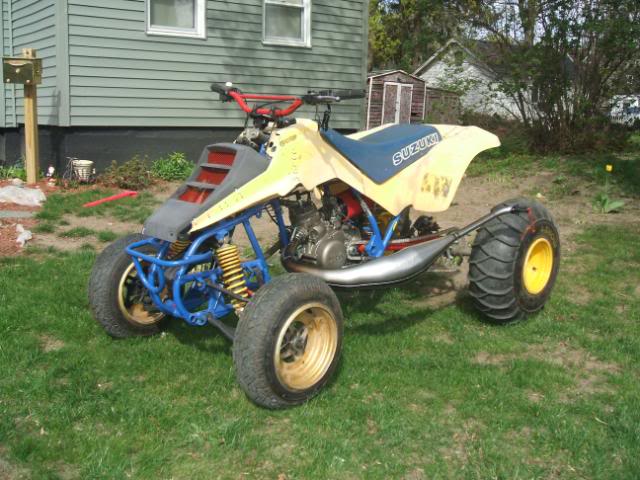

i dont have any pics of my blaster yet but here is my quadracer
Does that have any engine work done to it?
ya the head is milled .020, its port matched to the lower end and the cylinder is drag ported with the exhaust at 194deg and the intake is at 128deg reed cage is matched to the intake port, 34mm tmx mikuni carb with a uni filter, and an oof rdz drag pipe,

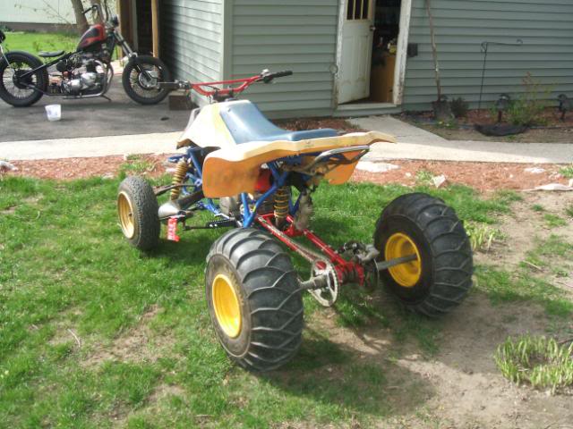

and the swinger is a plus 6 that kelly baldwin and i built is made of 1 1/4 chromoly .095 wall tubing and housing is from jj@a
