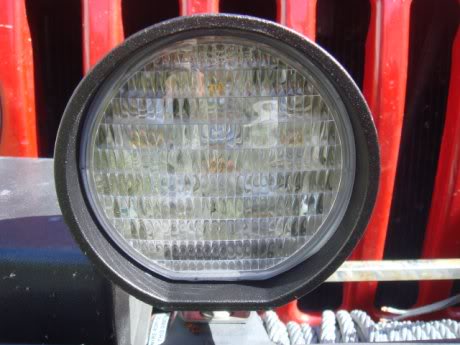

Here's a quick picture of the LED lights I already have on my Jeep as back up lights. I figured if U can wire them to the wheeler instead, they'd come in handy. The are prototype 12 LED work lights from a tractor trailer. I got them when I worked at a light mfging plant back in 04. they're so bright I've used them as headlights when mounted to the front of my Jeep.
Those lights are probably going to want to draw too much power from the stator. That would cause many problems in the future. I would recommend getting the walmart driving lights and switching out the light bulbs to 20w each. This sounds like they wouldn't be bright but they are brighter than stock. As for the capacitor I am really not sure. I have wondered the same thing for awhile now. It does get annoying when they dim.
The draw from the LEDs is less than a standard bulb. When I hook them up as turn signals, they blink rapidly. The computer in my Jeep thinks I have a blown bulb. That's what got me thinking to use them on a quad.
