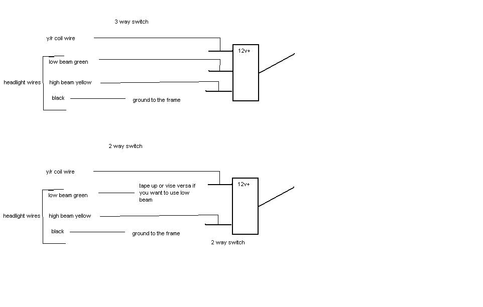

Hello everyone...recently bought an 03 blaster and the previous owner had redon the wire harness and didnt connect the head light..well long story short i want to connect it..i have a multi switch that i want to use bc he got ride of the light swith and installed a kill..
i have this kinda switch...no what do i run it to tho,as in the wire colors..i know black is ground but whats pos and neg??
also on the back of the light is a YELLOW..GREEN...BLACK wires.

Thanks in advance for anyone that can help me out.
idk if thatll work a 3 way dpdt swich i think it is will prolly be the best u will havelow and haigh and off and alot more easyer cuz it has enough prongs for everything lol
it will work off the 3way switch,my bros blaster is wired like that buttttt he lives in FL and on Vacation right now so i cant ask him...sucks i know..lol
use the yellow/red wire from the stator for the power to the switch.....then run the back wire on the light to a bolt on the frame and use either the yellow or green to the other side of the switch high or low beam...cant remember what is what....or get a 3 way switch and hook the yellow/red stator wire in as your 12v source and the yellow and greens wires off the lit to the other 2 prongs for high and low beam
can i run it like this??
yeah i think that will work, just dont seal anything til you know it works, if i were you aswell id use a low beam :) i know it sounds stupid but high beam disperses the light quite high and makes whats infront of you dimmer, i use both quite a lot but that just my 0.2 I:I
