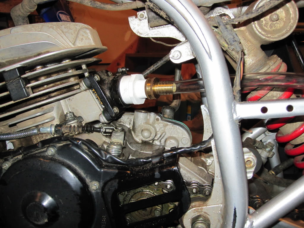

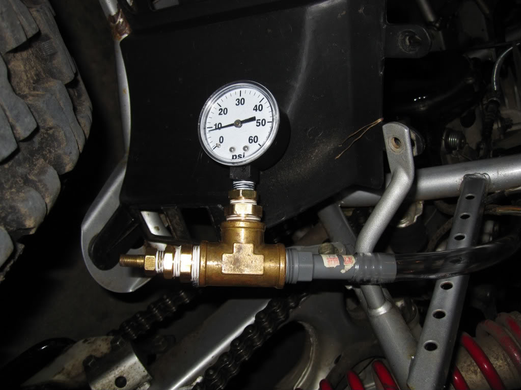

I finally got all the parts I needed to make my leak tester. Only problem was that my gauge was a 60 psi but that's no big deal. Anyway found out I have zero leaks I:I. It held around 8 psi for 10 mins. So now I know my jetting is not going to be messed up. Here are some pics:

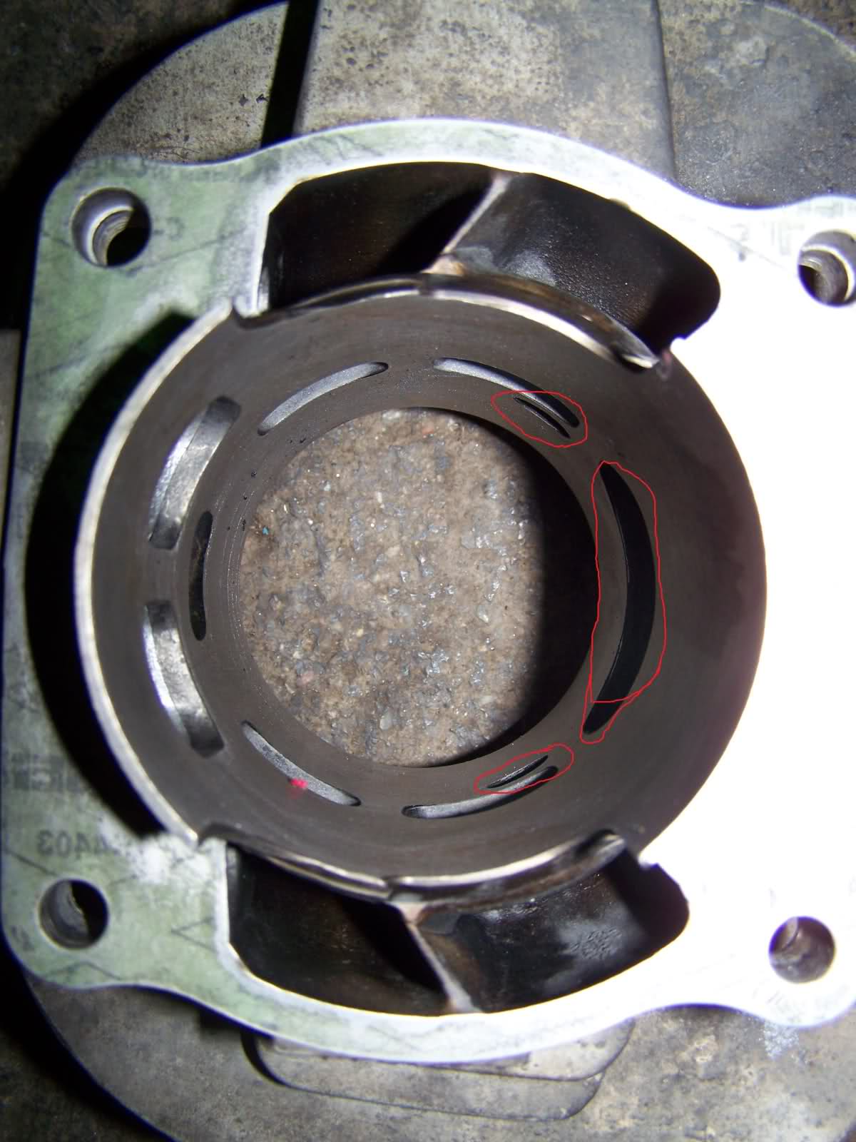

If you have a vitos 240 kit, why does your cylinder say "195cm"? not to be mean or anything but just wondering?
I questioned Brandon at Wildcard about my cylinder on the phone one time with the same question, and he told me that a lot of the earlier vito's 240s said 195cm3 on it still. I was worried that my cylinder was just simply resleeved, but that's not the case. He told me as long as it has triple exhaust ports in it, it's a vitos.
Oh, well, just wondering. Im gonna be saving my money up for either a ported Vitos 240 or a ported Phantom 240 (non-fire breather)
Yah mine has triple exhaust ports, I thought it was weird it said 195cc. I thought it was maybe sort of a stealth idea, but it's a different colour from stock so that doesn't really work lol.

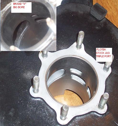

this is off flotek's site.
it is just instead of the one normal exhaust port, you add two small ports on either side of the original one.
edit: better picture of RDZ
