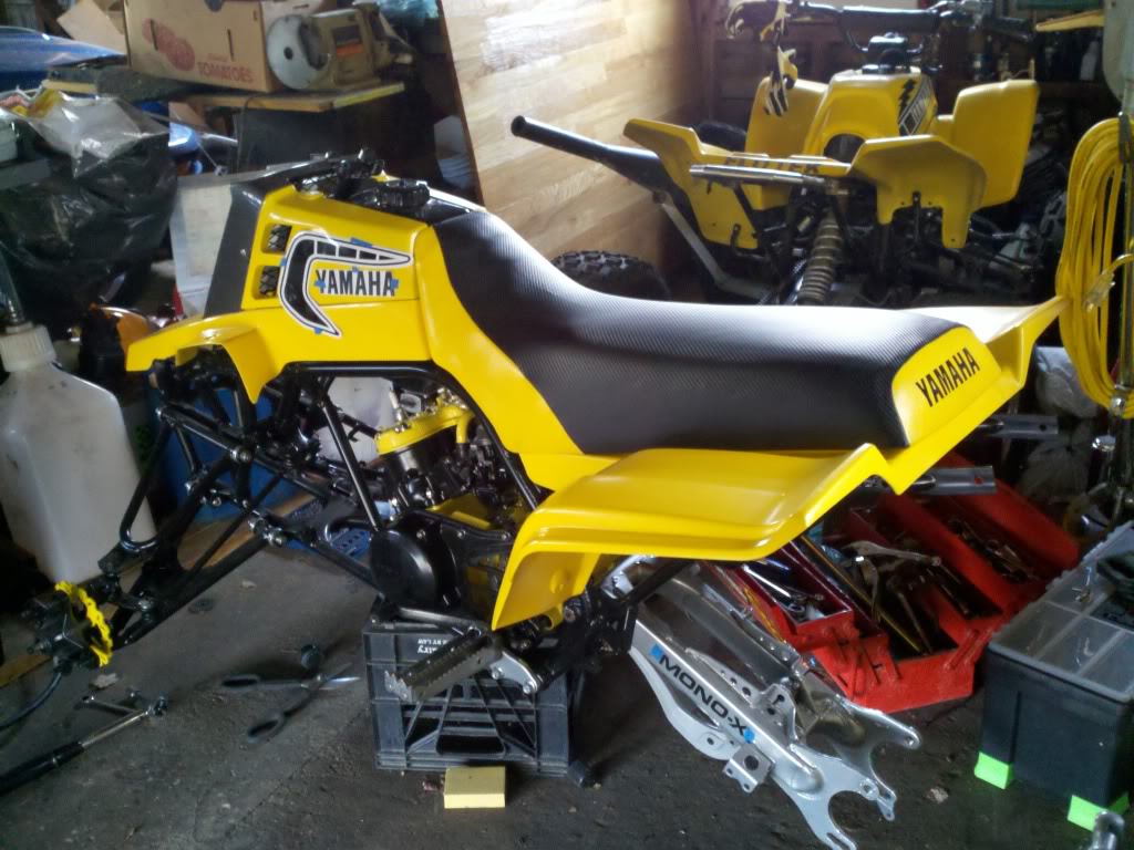

All the plastics on this bike were done with it.
Look at those sweet rear platics!!!!!What are those off of.lol Looks sweet as always bro.Nice job.
